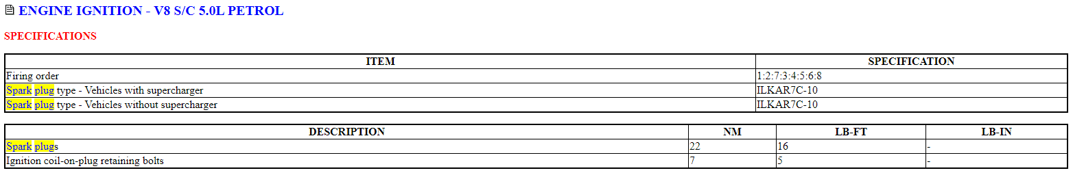

Yes..This is for V8. The V6 info is below. Appears the V6 plug is also the same OEM Heat Range (7C)...And same general rule on adding cooler plug would apply as well, based on increase HP, and Gap based on increased boost/pressures. Always best to check with your specific tuner on plug and gap recommendations. The info for the V8 I listed above is in line with what is recommended by VAP for their tune.
V8 OEM Info included below as well.
DC

VAP has changed their position on plugs, and NGK has apparently changed the pattern on their HR8 plugs. So now appears staying with the HR7 is preferred.
Appears Jaguar was initially using HR6 and switched OEM to HR7, so they are already 1 range cooler than original OEM plugs used early on.

Yes...That is correct - NGK (94940) ILKAR7C10 Laser Iridium Spark Plug - That is the correct one. Recommended to be gapped .028-032. I went with .030 and will install before my 1/2 mile No-Fly-Zone race next month. 👍
