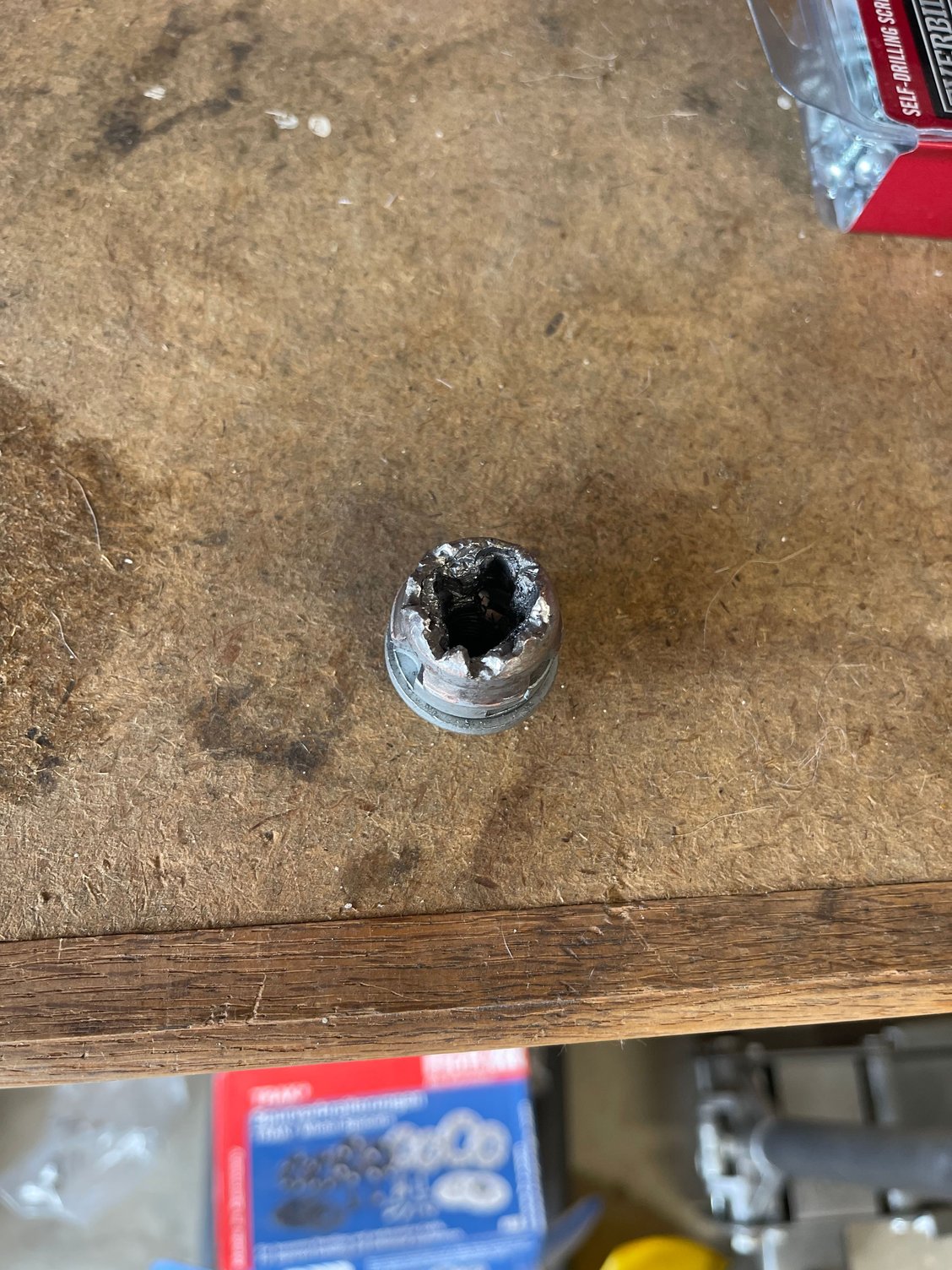

Hi everyone, so a little while back I posted in regards to getting my dome locking lug nuts off. I have since found no solution that wouldn’t involve damaging the rim besides drilling through the locking nut and drilling out the wheel stud.
After a painstaking 6 hours or so I was able to get one of the locks off with somewhat minimal damage to the rim. My tire was losing air and I thought it had to do with a puncture but it actually was a hairline crack on the back of the rim, but that’s another story.
I am now trying to source the correct wheel stud to replace the one I drilled out. I have seen posts saying Dorman studs ( part # 610-543) will work. I would just like to confirm this or if anybody has used something different please let me know. This is for a 2016 F-type R.
I will leave this pic of locking nut I was able to remove. 1 down l, 3 to go…
