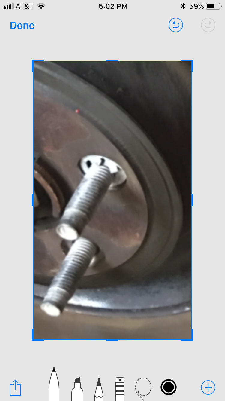

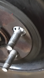

Originally Posted by BOulderGT3
When I took my rear wheels it took too much effort to get the lugs off. I broke a rear wheel stud putting them on. It snapped at 80’ lbs.
turns out jaguar doesn’t sell studs but only the hub. I havem’t lookked At it closely. Is there a way to replace individual studs? Thanks.
I saw your other thread on refreshing your red calipers and thought the ends of your wheel studs looked like they had been clamped down. Was this pic of the rear?
Yes. That was the RR caliper.
The more I think about it it had to be the tire shop way over tightening.
