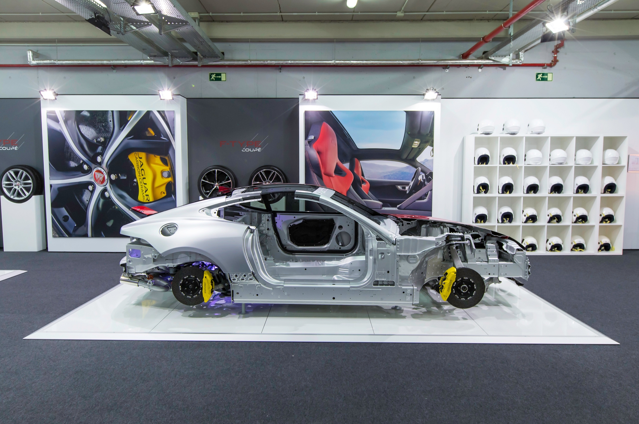

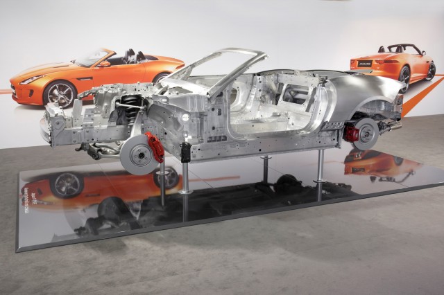

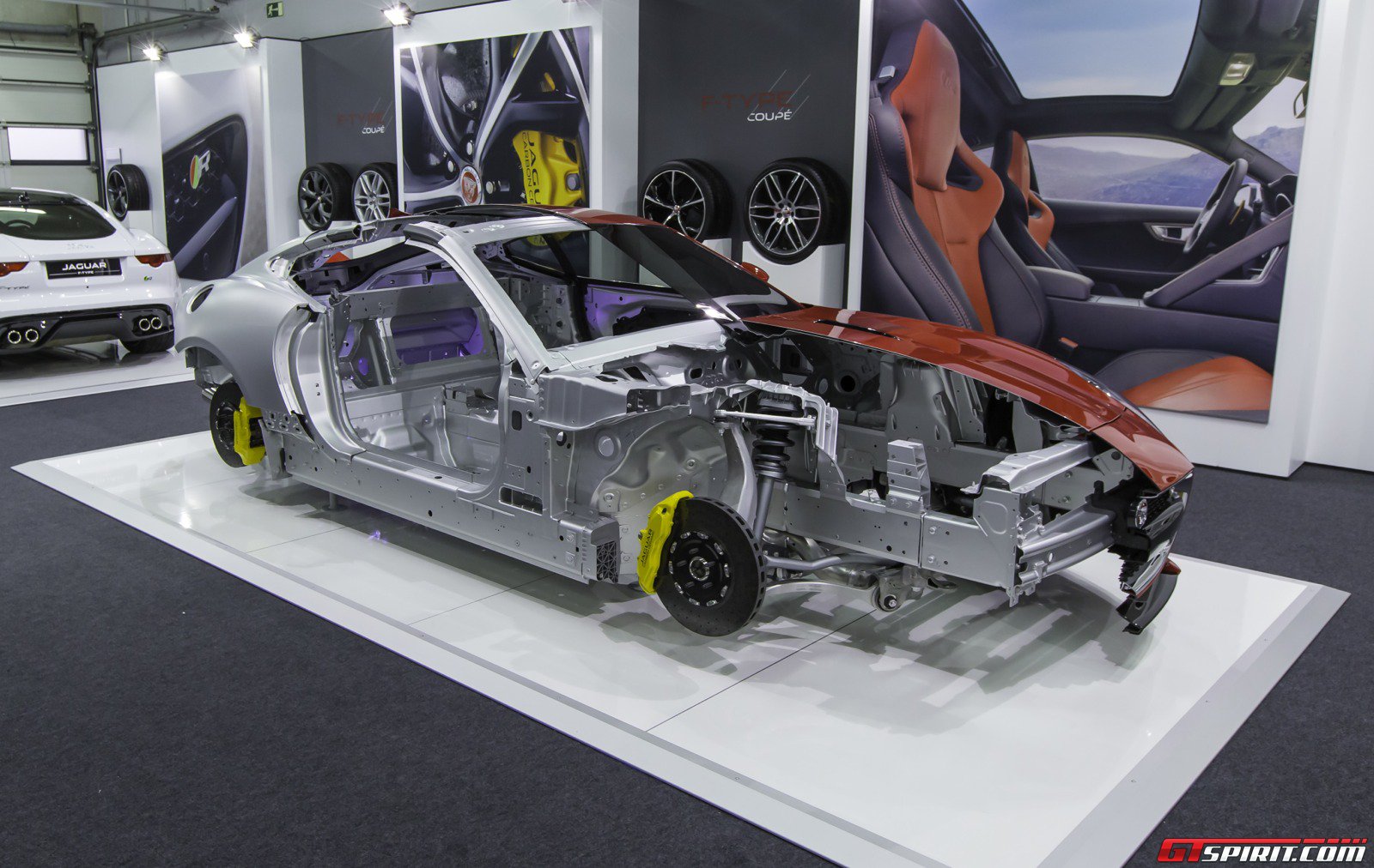

I'm sorry but that's just not correct.
The convertible chassis is fantastic and very stiff, and the vert is a beautiful car but it's just not right to say that it's identical or equally rigid to the coupe. Nor is it right to say that you can't distinguish the soft top from the hardtop from the inside. Multiple reviewers have noted that the exhaust sound and wind noise are lower from inside the coupe (not necessarily a plus, given how awesome the exhaust note is!). It should also be self-evident that this is the case.
The coupe is more rigid, and Jaguar is on record with this fact. The coupe has engineered aluminum beams that run up the A pillar, and down through the rear of the car. They are reinforced with additional structural pillars that run up just behind the seat headrests.
The roof frame is also reinforced to give additional transverse rigidity to the chassis, and the overall assembly including the roof panel -- glass or metal -- provides the car with better torsional rigidity than the convertible.
The attached cutaways should help illustrate. Sorry don't mean to be harsh, but I think it's important that folks get the right info.

OK, I stand somewhat corrected.
However, I've owned more than a dozen convertibles over the years, and I've never driven one with absolutely no perceptible body flex until the F-Type. I will accept that the coupe may be more "rigid" from an engineering, failure-analysis standpoint, but that extra rigidity is undetectable from a handling and feel standpoint.
I stand by my comments on the roof not appearing to be a soft-top from inside and being hard-top-like, quiet inside. I wasn't comparing it to the F-Type Coupe, per se, just many other hardtops. If the exhaust note is, in fact, louder inside the convertible with the top up than the coupe, I agree that is a good thing.
