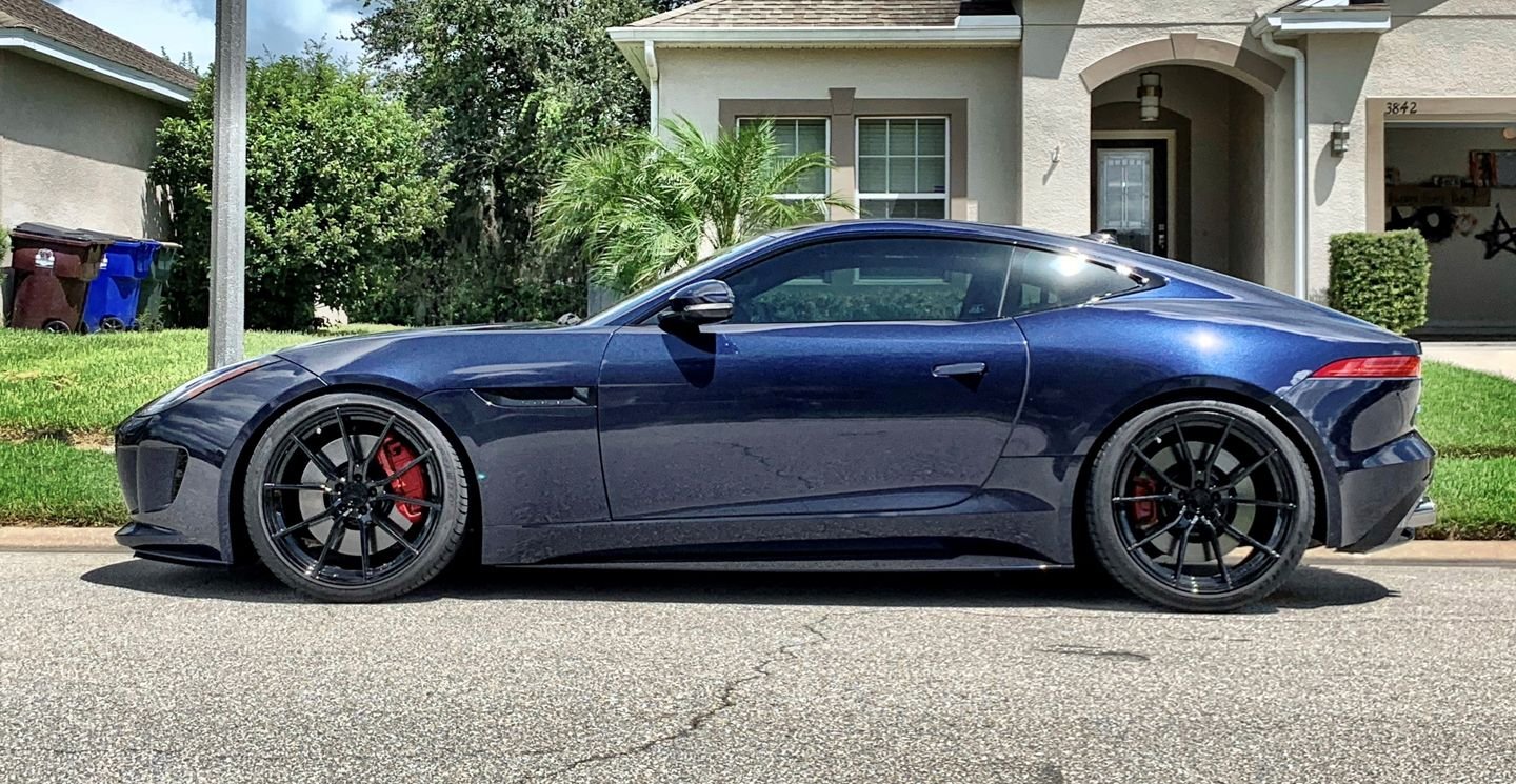

I'm looking at a set of wheels for the F-Type and the front have a +35 offsite. Will it fit under the fender or will it stick out?

That would be the same as adding a 20mm adaptor (spacer) to an OEM wheel. That should be ok in front, but I don’t know if anyone has gone that much in front.

thanks, but would the tire stick out of the fender or still underneath?

It would be damn close to dead level with the top of the fender, I have 15 mm spacers with stock 20" blade wheels and stock 255/35ZR20 front tyres and the top of the tyre is about 5 mm inside the top of the fender.

I have 20x9 with 35mm offsets now. It will fit fine.

Exact same setup I have. No issues at all 20x9 ET35 Fronts Vertini RF1.2 Wheels and I am lowered 1.3" on H&R Springs
Thanks for confirming! You have a beautiful ride!
