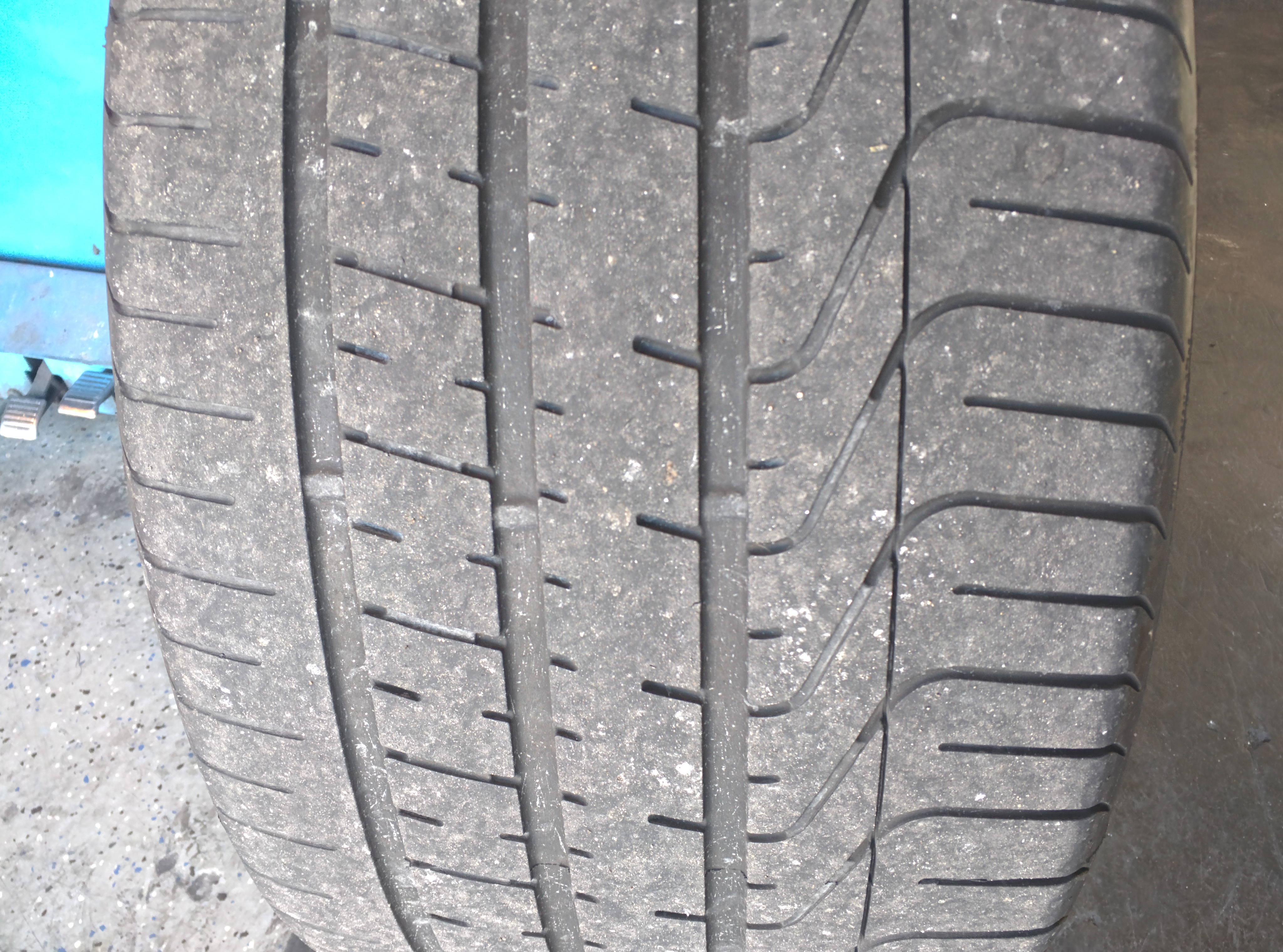

Originally Posted by XFactoR
...is there a point on the P zeros that they simply are not functional in the rain, even with tread?
Yes, at 16,500 miles I changed these Pirelli P Zeros out because it was too dangerous on the highway in wet weather.
