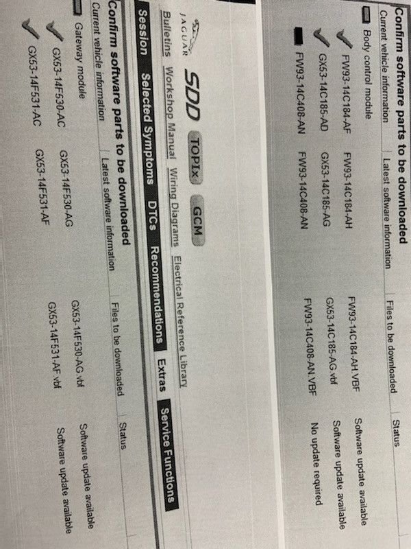

My 2016 R used to pop and crackle until Jaguar applied software update, and now it barley pops at all. Maybe the same happened to your car? I have tried to get Jaguar to reverse the update but no luck at the moment.
The patch they applied is

So I have a 2017 f type r awd also bought it abs it was a crackling evil ******* from day one but after having a front left flat tire replaced at jag with our asking they ran some sort of software update including the old unpatched version and all the pops and bangs from over run were gone. Took it back to jag and showed them a set of screen shots from this forum with the updated JTB495 patch they agreed to look into it a few days later they applied it after literally breaking down the entire process to them which I found https://www.jaguarforums.com/forum/f-type-x152-72/f-type-r-exhaust-noise-pops-189453/
or here
https://www.jaguarforums.com/forum/f...-189453/page3/
long story short it was better but not back to normal so I slapped on a quick silver exhaust and boom back to normal and then some louder better low idle and over run crackles back to full audacity. Anyway hole that helps feel free to reach out to me on ig too @thomas_keal Cheers
