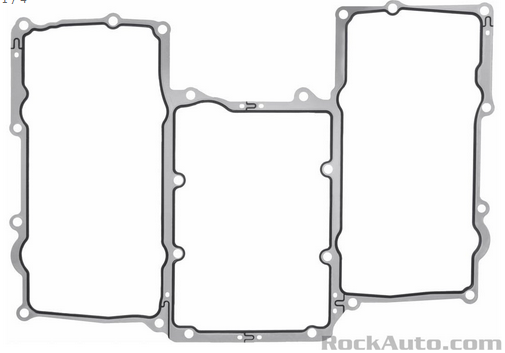

Originally Posted by Carbuff2
What is the hassle?
Is the supercharger top cover sealed with a silicon?
Asking for a friend.
Yes it is, .
Well, actually it isn't/shouldn't be...the OE gasket looks like this..
Funny, when I called around looking for one, a NAPA guy said "Do you want the RTV sealer instead?
Old Apr 2, 2025 | 07:59 AM

I thought we are talking about the snout silicone gasket to get the isolator...
Old Apr 2, 2025 | 09:19 AM
Carbuff2's Avatar
Joined: Aug 2018
Posts: 2,247
Likes: 928
From: Exit 30 in NorthWest NJ
Sorry for the Topic Drift!
