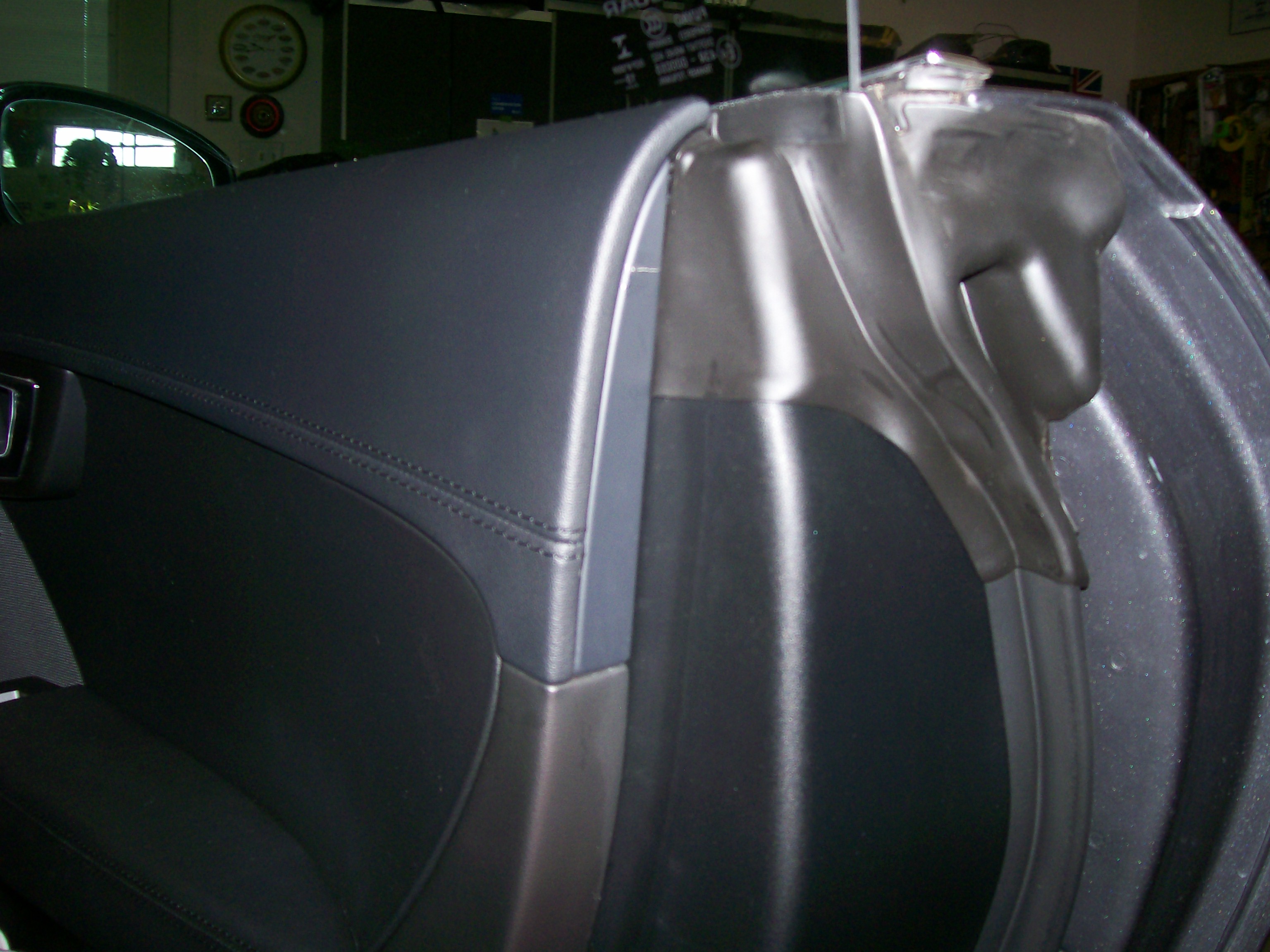

HI and I believe I know the piece. A photo of your issue would help, but I'm pretty sure it's at the upper part of the door, triangular, but a really long triangle. I was doing work inside my door and the clip on this piece snapped off. I was able to superGlue it back together and put the piece back on the door. However, my OCD took over and I wanted to replace it with a new part. UGHHH... it was $50 and, at the time, there were no used ones around. So I put in some overtime and bought it. It may hold together if you have the clip that must have broken off and glue it. Otherwise, I don't think you want to glue the piece in place. Isn't there a screw to get the door panel off under it?? (trying to remember the process). You may be able to get it to stick in place with some poster putty. It holds well and will not damage either surface.
UPDATE: I found a photo in my file that shows the 'repaired' piece.. you can see the white glue line.

Attached Thumbnails Door trim piece broke/fell off-t2r6271pvja-2-.jpg
