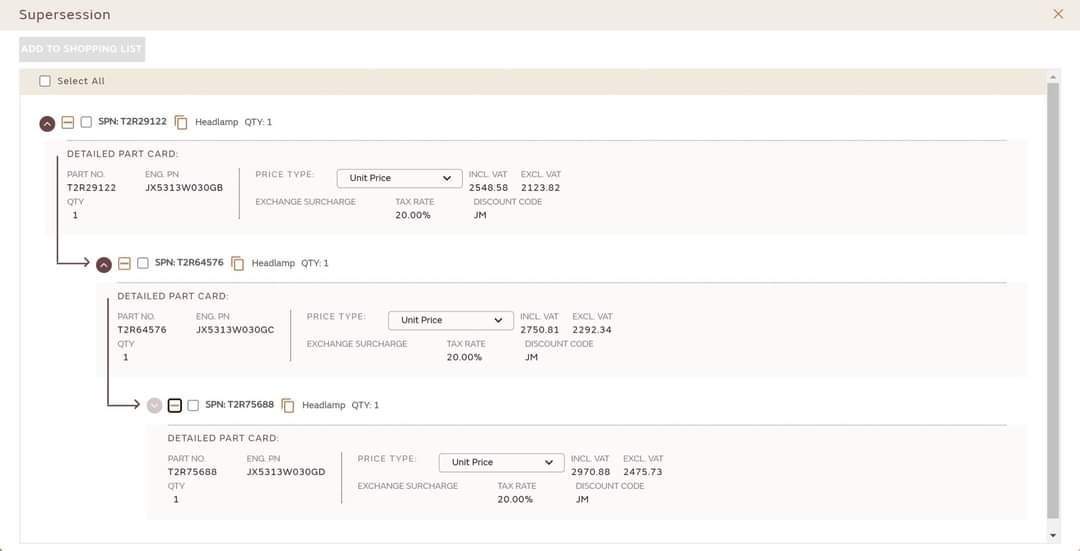

Left side headlight part number progression.

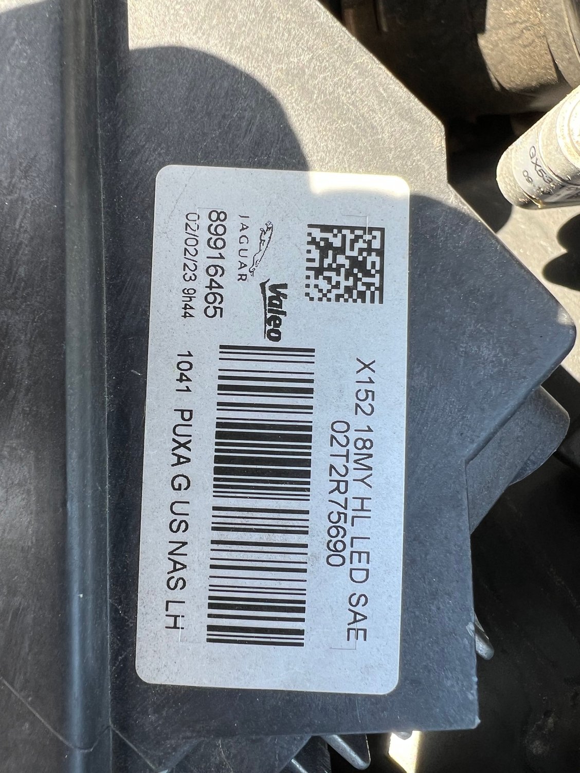

I had my left side headlamp replaced in 2023. My car is a US model, and the headlight part number on my replacement is T2R75690. Hoping it’s one of the “fixed” units so I don’t have to deal with it again in the future.

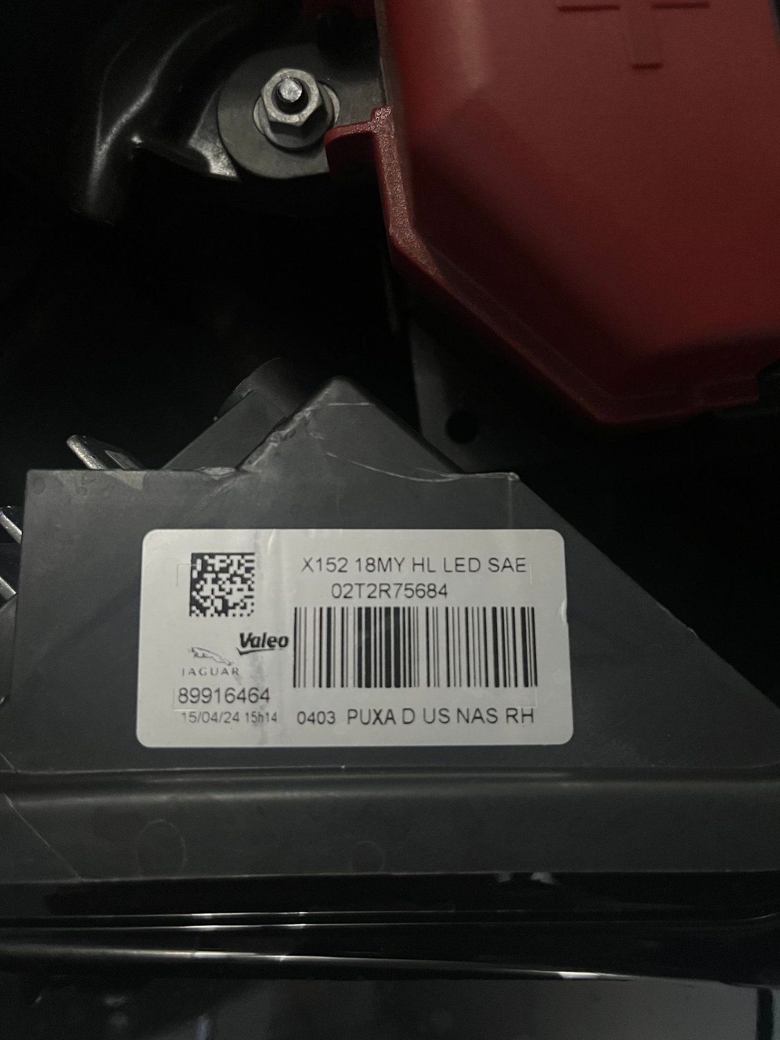

Anyways, back on track - so it seems like the revised lights are distinguished by the PUXA code. And what's pretty interesting looking at the pics earlier in this thread they've been produced for more than two years now.
