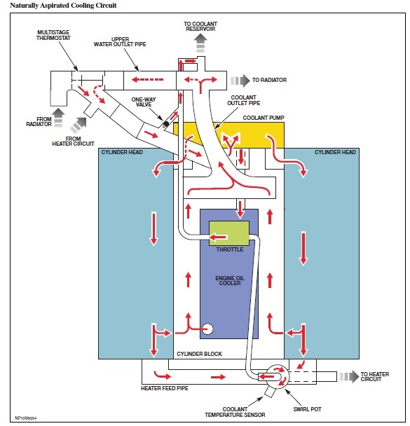

Thanks! This fact has me thinking about an external auxiliary cooler. Does this mean that the air-water heat exchanger that cools the charge air, also cools the oil?

No , oil is cooled by the engine cooling liquid . Charge air cooling is
separated from oil and engine cooling .
