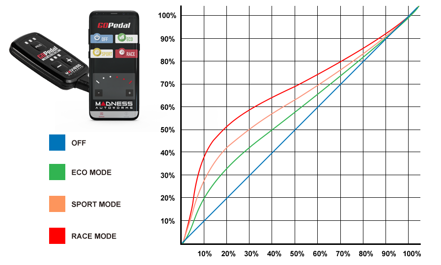

As for what non-linear throttle response could look like:

Yup that is also pretty much what dynamic mode does for the throttle, you just want it to be dynamic-er. Most tunes do the same as well, they make power but that sharpness you get with tunes is often just more aggressive throttle mapping. Definitely makes a difference in part throttle driving day to day where we aren't using all the pedal. I actually put my throttle to normal in custom dynamic because I have maybe 650ish hp and rwd to contend with.

On a previous car I mapped my DBW throttle to roughly the inverse of ECO MODE above. At lower throttle openings it was easier to modulate smoothly, and only a slight lift from full throttle was needed for smooth upshifts at full power. Full power on that car was pretty low, but it improved drivability for me. With my F-Type, I have both of my configurable modes using the less aggressive mapping. I can cope with steering and suspension feel differently between modes, but want the same throttle response all the time.

But yes, and the trans sees those throttle and other input signals and changes its behavior, too; “in detecting a more spirited driving style, the transmission will automatically make the shifts more aggressive and move the shift points higher.”
That’s what I’d like.
Will I be satisfied with that, or will I just be wanting more power and torque anyway? That I don’t know, but $300 for a customizable and completely hidden Madness GoPedal isn’t make-or-break, and I’ve liked what it did for the Giulia, so I’ll give it a whack.

I just installed the Madness GoPedal on my '16 V6 and "Sport" mode really took me by surprise, just damn quicker off the line. I'm scared to try "Race" mode. The bluetooth remote puck as well as their phone app provides very good incremental control over the throttle curves

Hey, that's cool! Thanks for the feedback! Did you keep your usual drive position/settings (e.g. car Dynamic + shifter Sport) and just layer the GoPedal on top of that, or what?

To gopedal is kind of an overlay as you describe it. It essentially changes the response curve of the accelerator pedal to tell the engine how much to rev up sooner, so to speak. So, for instance in sport mode when I press the pedal down the engine accelerates faster at less of a pedal push which increases acceleration. It's kind of like putting it into dynamic mode, and when I do put it in dynamic mode it's even faster response plus the dynamic mode changes the transmission shifting response as well so it's kind of a crazy acceleration at that point.
