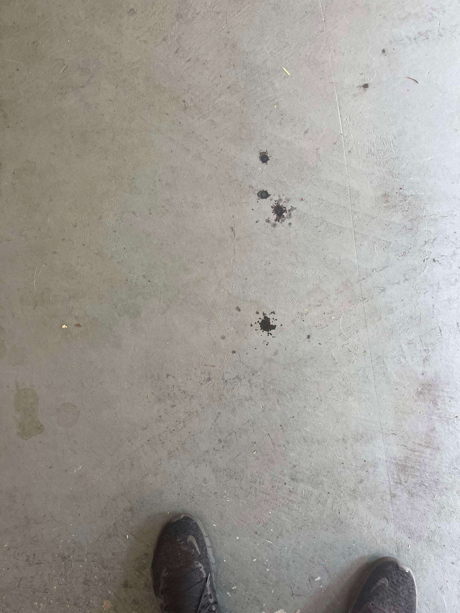

About 3 weeks ago, I noticed two spots of engine oil on the garage floor. I’m not exactly sure where it’s coming from, but it appears to be toward the back of the engine. I’ve attached a screenshot. Since then, there haven’t been any more oil spots, and I’ve driven the car 3–4 times.
My questions are:
  1. What could be causing this?
  2. What should my next steps be to diagnose or fix it?
Also, I need to replace my front brakes. Can anyone recommend pads and rotors that would work well for my 2015 Jaguar F-Type V6 Coupe?

The car needs to be put on a lift, undertray removed, then investigate the leak's source. If the oil stains are difficult to pinpoint, then everything needs to be cleaned up, driven for a period of time, then re-evaluated. Would help to see where (in relation to the car) the drips are positioned.

Several sources for oil leaks.
#1 is the brake boost vacuum pump. Dealer will want a grand to drop all the oil, clean the effect area, replace the pump, change filter and add oil.
All you need is a new pump from FCP and a Husky very low torque wrench from Depot. Put the front of the car up on stands so the oil won’t drip out too much. Clean effect area and swap out pump. Watch torque specs on the two bolts.
#2 is the oil filter housing. If you’re using aftermarket oil filter kits you should look at the housing where the black cap screws down. Aftermarket gaskets don’t seal as well as legit JLR seals. Oil drips out all over the passenger side front of motor coating the alternator which can lead to early failure.
#3 is valve cover gaskets. I’m willing to accept a little seepage here because changing them out is not cheap.

With the undertray, I don't think you can tell if a leak is in the back or the front of the engine. It's going to just come out where the undertray lets it.

Oil level sensor is where the oil leak and one other spot. Ive attached the video. Thoughts.
https://rotracker.goauto.ca/?share_key=fr9YF-XuGkvsgetW8aWgf3CmVtA=
jaguar response
Recommend to replace oil level sensor along with an oil change $1209.89+tax. and monitor the sipping from the rear main area. And recommend to replace front brake pads and rotors $2427.51+Tax. Please let me know how you would like to complete the repair. Thanks.

Have your independent do the oil sensor, have him check the brake boost vacuum pump and the oil change. I wouldn’t worry about a rear main seal yet. Oil sensor costs $100 from Harper Jaguar Parts.

That doesn't look like oil; it looks like water mixed with soot. At any point did you have your car parked backed in? F-TYPEs will drip condensation from the exhaust; mixed with the soot and it looks exactly like that.

Agreed, looks like the classic sooty water drip to me, how did we all miss that?
If so nothing to worry about.

Its def oil, the jaguar guys charged me $600 for diagnostic. Kinda crazy but sensor i linked the correct one ? Also I posted their video with their analysis.
Nvm after speaking to the rep he said its not an oil leak. Dang i wish i saved the $600, rip. Alright just replacing brakes.
