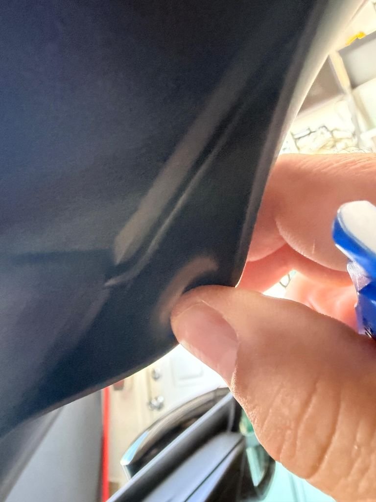

Picked up my trim molding at the dealership this morning. Sadly, no clips came with the wheel spats so they ordered 12 of them for me because each molding actually has 6 indentations which should make it more secure.

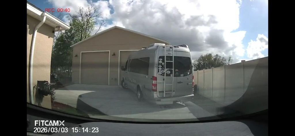

A few more photos from the dashcam after fixing the rear camera to the back window. I want to route the cable to the back camera via the rubber grommets and rubber hose that is in the back hatch. But no hurry on doing that. Good for now.

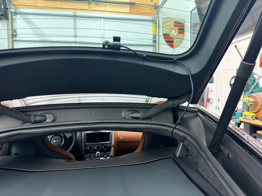

I have not completed the routing... only routed the cable to the back... inserting along the trim/molding... then, in the back, I just left it exposed for now. Plan is to route it via the rubber hose that connects the rear hatch light to the rest of the car.
Getting ready to go out on a motorcycle trip... let me see if I can take a few photos to clarify what I am planning to do...

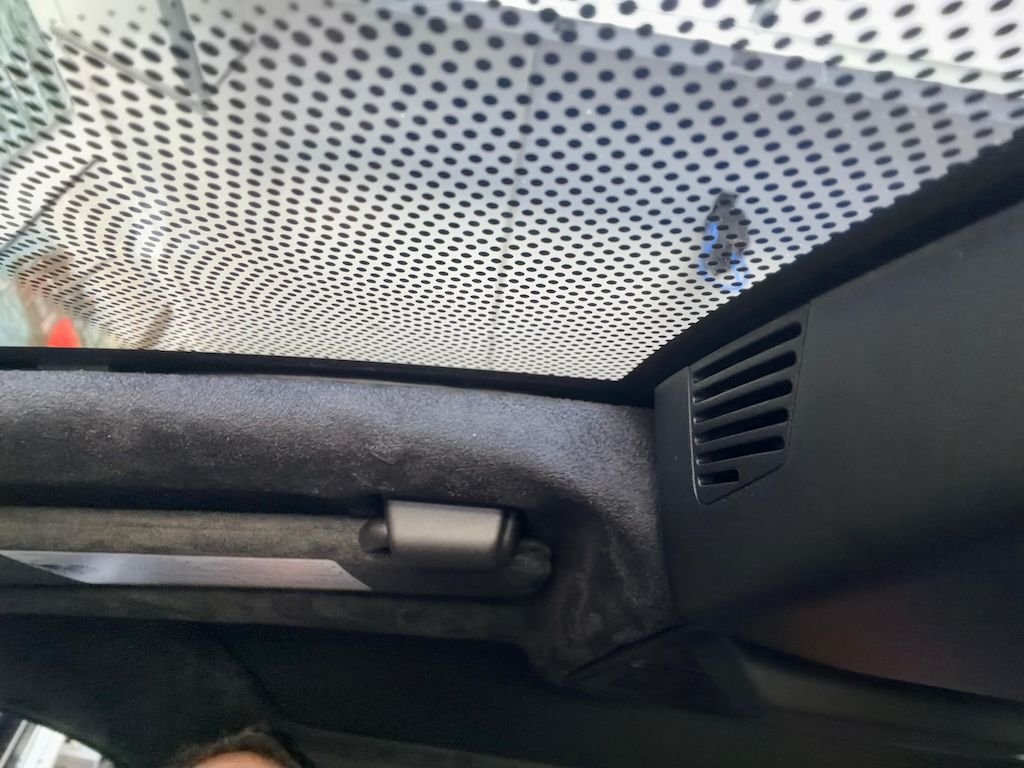

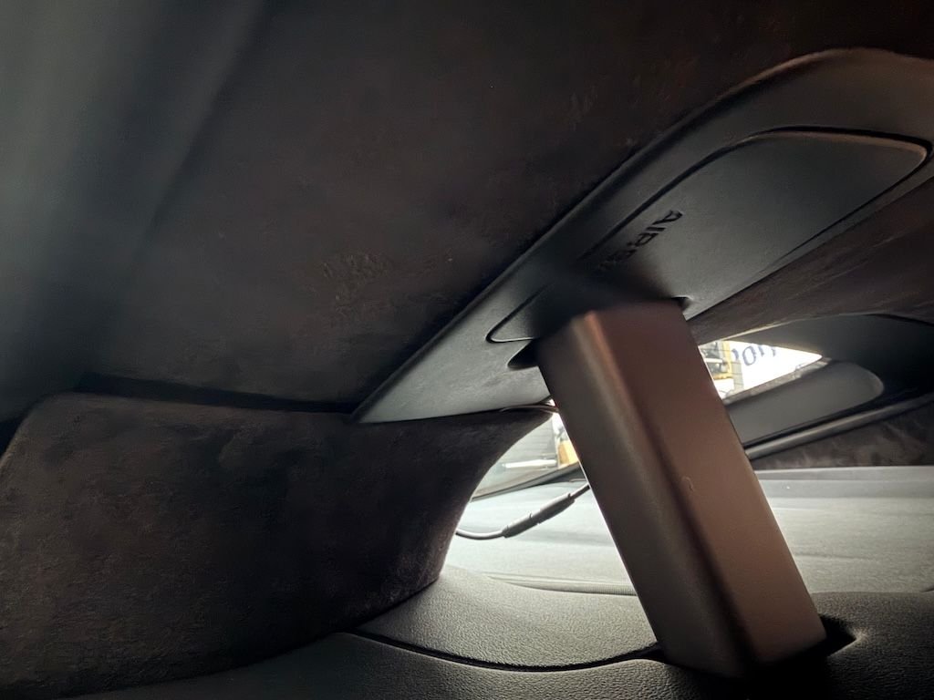

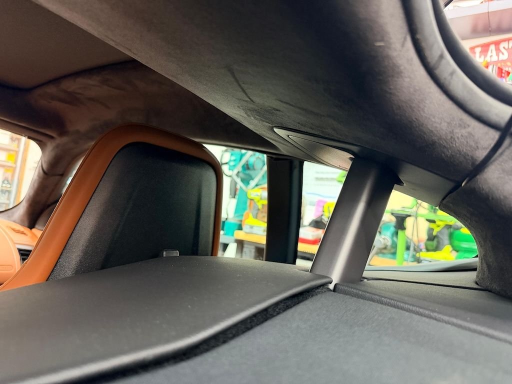

A few photos... again, not finished, just done good enough for it to work while I finish routing the cable.
Cable is routed behind the trim and behind the rubber door seals... in the front it is routed along the windshield pillar/trim... I hope that made sense. It is easy to insert using a plastic trim tool to help you create the gap to insert the cable. The rubber door seal is even easier since that one you can just peel back with your fingers as you insert the cable all the way back into it.

And here is what I was planning on doing, if it is not too difficult to remove the grommets on the ends of the rubber hose. Then route the cable and make a small hole on the lid cover to get the cable out. Finish with a grommet around the cable. I hope that makes sense.
Some of those grommets on other vehicles, tend to break if you remove them... so if they do not come off easy, I will leave it alone and keep it as it is now.
Also, I did not center the camera on purpose. I did not wanted it in my line of sight when looking through the rearview mirror.

In the front, yes, along the top of the window tucked behind the blackout material. The wire is not exposed when reaching the a-pillar, that is a two piece trim and the cable can be inserted in the split between the side cover and top cover.
A plastic trim tool is perfect to get the gap open to insert the cable behind it.
A few photos for clarity:
Here I tried to pull the cable out a little bit so you could see the routing...
Inserted back using plastic trim tool (well, that one in the photo is just a bicycle tire removing tool since I had put away the trim tools, lol)
Then you route between these two pieces
Using the trim tool to show better where it is...
From there is just under the rubber door seal...
All the way to the back and inside those two rear pieces... Now, looking at the photo, I can see that I need to go back and reinsert it... a little bit of the cable is not fully inserted. I can see it near the plastic trim for the rollbar.
I hope that helps.
