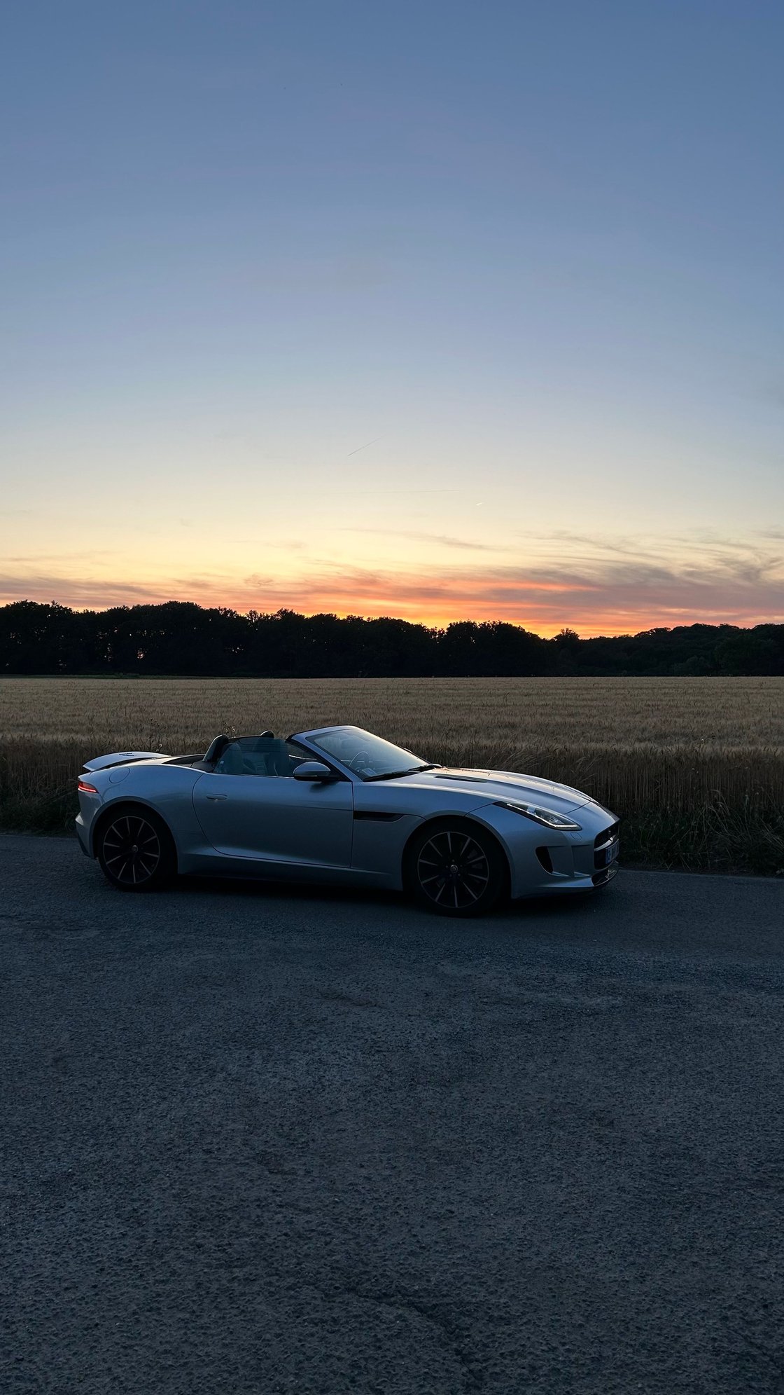

(in addition, there is a picture of the patient (the jag) for motivational purposes)
