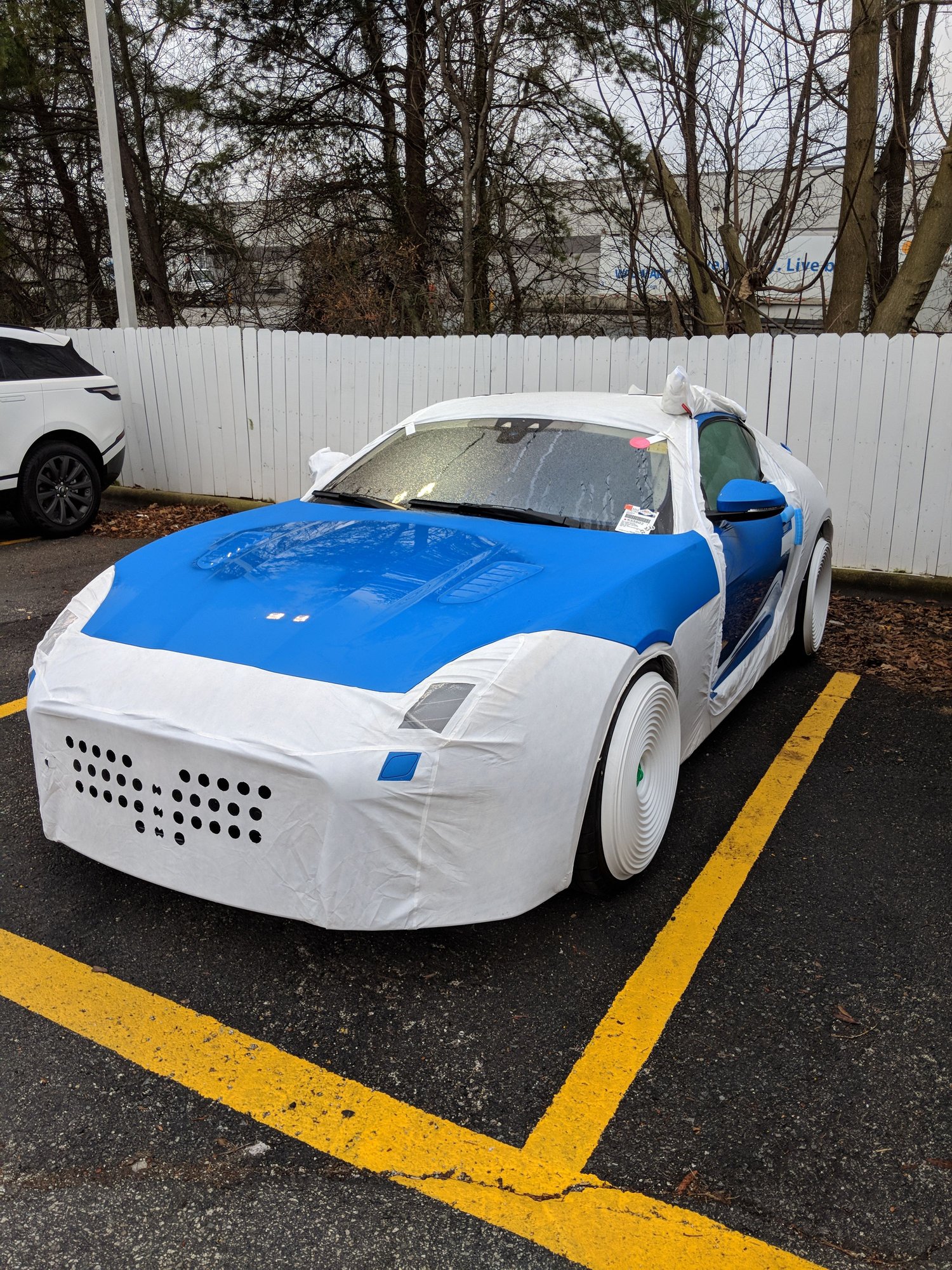

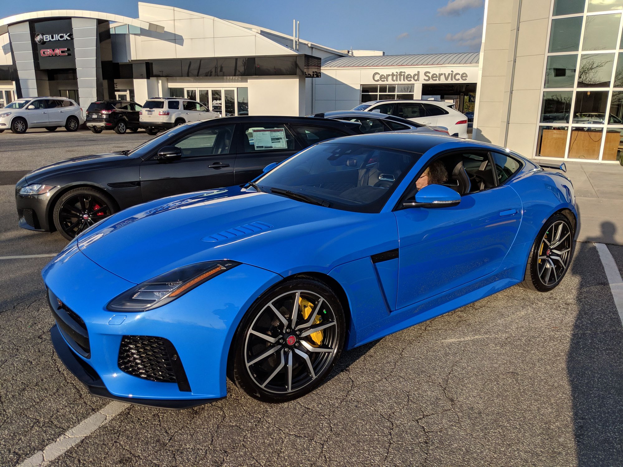

So, my mum ordered an SVR back in November. It was delivered to us Feb 22nd. My parents noticed an oil leak on their driveway so we took the car back. They had the car for 2 weeks. They replaced the crankshaft seal and some component related to the oil cooler, but I haven't got a copy of the print out from when the car was returned to us. The leak seems to have gone, but a new issue arose with regards to the brakes. Under light to medium pressure (the sort of pressure applied when approaching a red light, but not with urgency) my mum noticed the car pulled/drove to the left. Under harder braking the car straightened back out. I drove the car to see what she was talking about and sure enough it was doing just as she stated. She took the car back to the dealership Monday. I went for a drive with the tech (both he and I drove) to show and feel the issue. They have sent the information to Jaguar and have a TA open with them. They have tried cleaning the pads and rotors in case the oil that had been leaking was onto the pads/rotors. I'm assuming that their next step will be replace the rotors and pads, but so far the dealership haven't received instructions from Jaguar. By the way, the car is fitted with the carbon ceramic brakes. I doubt the issue is with the calipers, but who knows...

Sweet ride. I think the tech's are on the right path. It's entirely likely that a bit of oil got into the brakes. It wouldn't take much for the symptoms you're seeing. Cleaning should be sufficient, but I'd applaud the dealer if they're willing to replace pads and/or rotors. It's certainly a PITA, but should get resolved easily enough.
