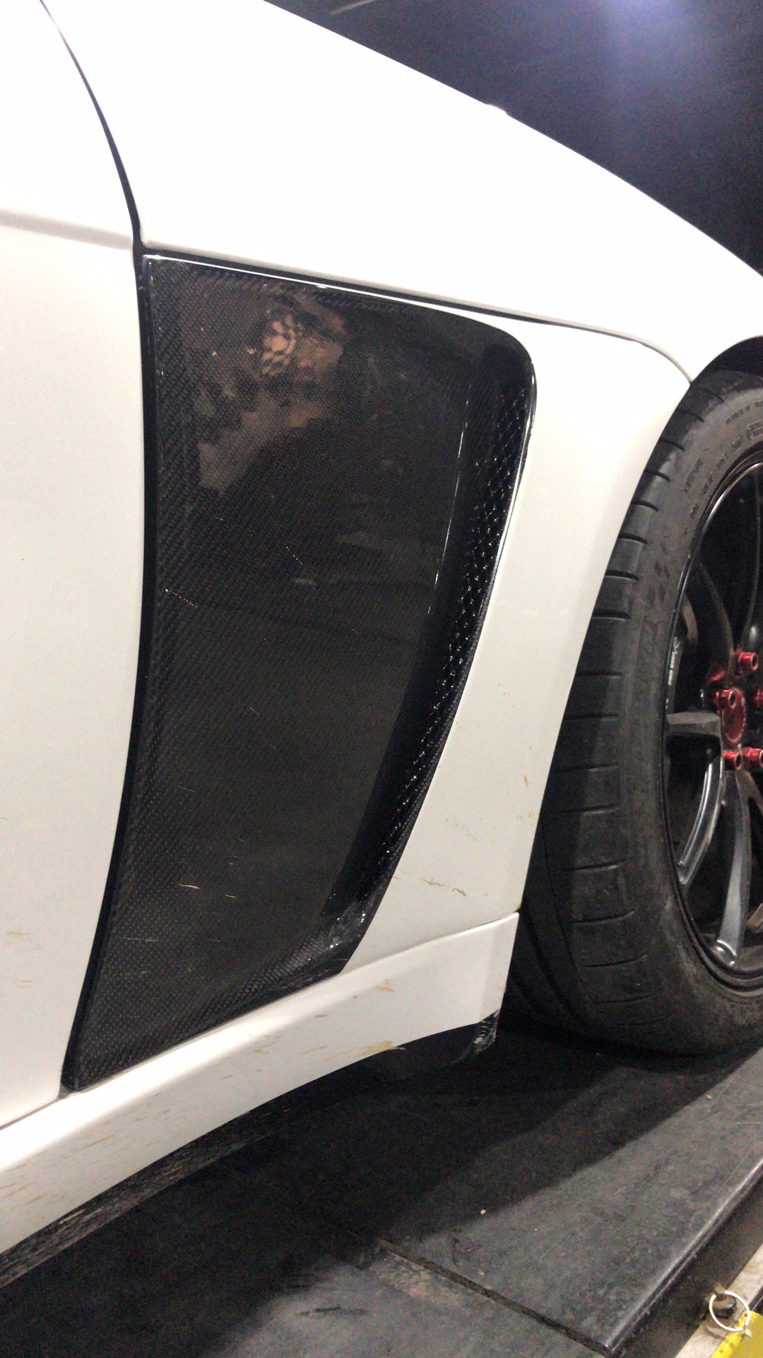

A bit of history with the car, it started out with the VAP tune, eurotoys crank pulley, 200 cell cats, eventuri intake, KW V3s, AP brakes 6 pistons f/ 4 pistons in the back. Custom brake duct from front side intake area
I also did the "free mods" such as taking the engine cover off, the foam in front of the intercooler off, I took off the pedestrian airbags off and used electronic cancellation kit on it, took off the eco battery which is my favorite mod.

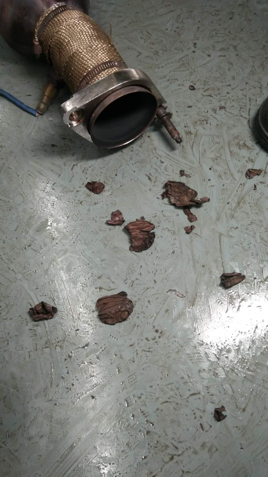

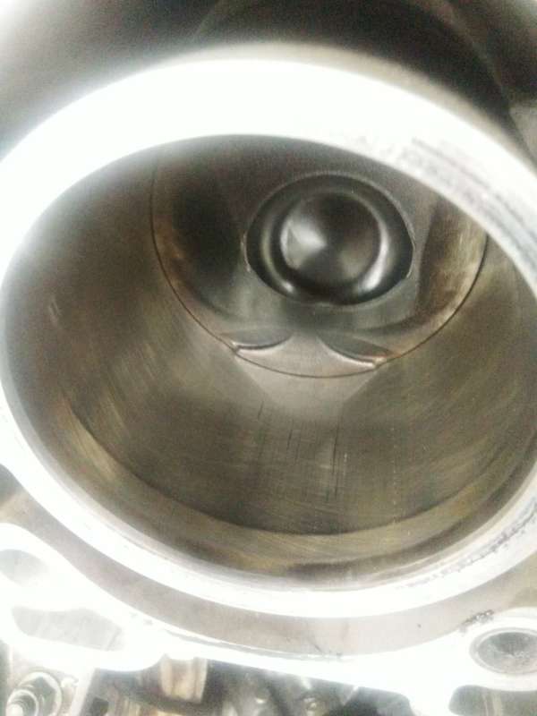

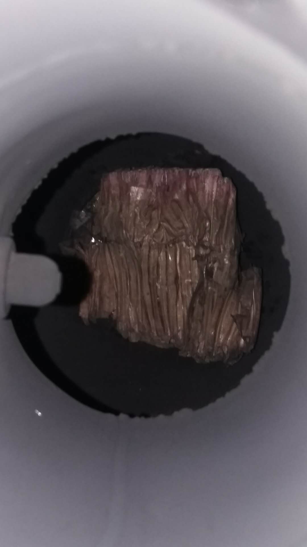

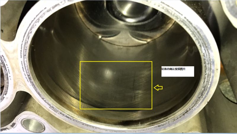

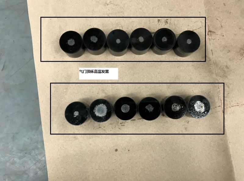

Then, my engine seized, I still don't know exactly what happened to it because Jaguar is gonna take the engine back and examine it so that could take up to 2 or 3 month. From what I am told based on the pictures I have, it is due to oil starvation issues, which is a problem with our cars. The digital oil gauge seems finicky and before the engine went there weren't any warning lights or messages or anything.
When we took it apart, the 200 cell cats had some strange stuff in it and it was failing, so I decided to go straight pipes for now.

That gunk in the cats is burnt oil that made it's way past the disintegrating piston rings. All of us should put a bi-weekly reminder in our calendars to check the oil level.

Then, my engine seized ... due to oil starvation issues.
This is not the first report of this happening to AJ engines. What was your oil change interval?

My oil change interval is every 3000 miles. However it's not a daily driver so time interval wise it was almost one year since my last change.
I was actually trying to get the oil change done one week before the engine went but due to holidays I couldn't schedule it in.
