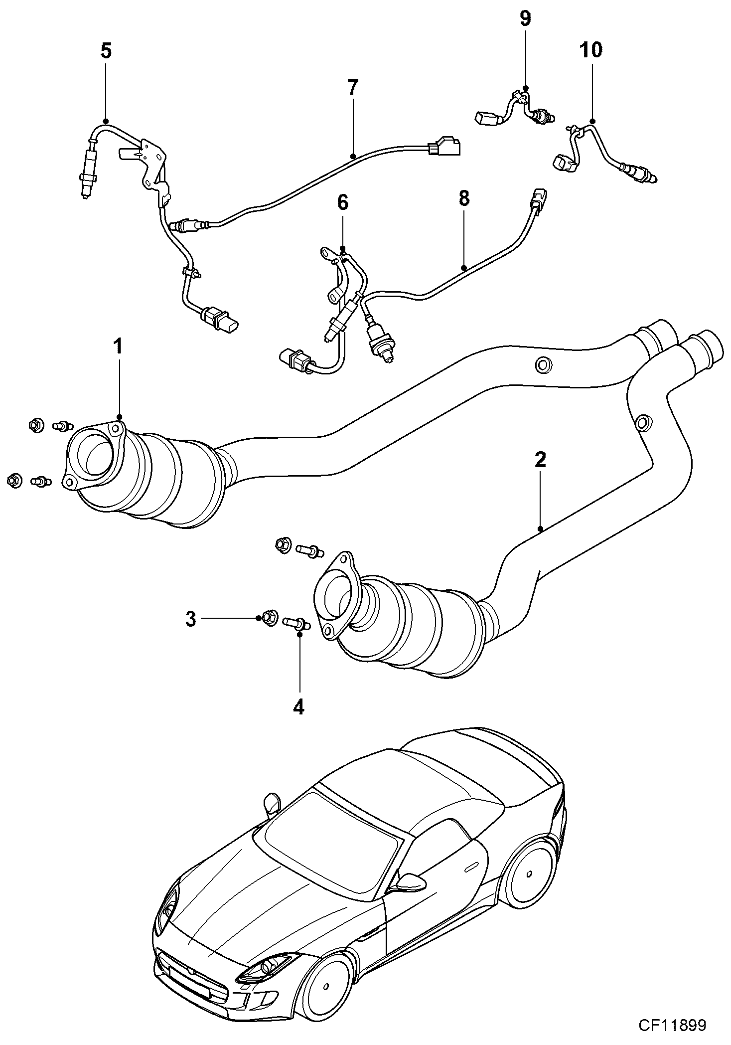

The downpipes aren't all that special, the only real complication is the flanges that will need to be fabricated.
F-Type V8S and 100-cell Catalytic Converters - what would happen?-cf11899.png
They won't be an off-the-shelf flange, but not overly difficult to make either.
Shouldn't be that expensive to do...
Any chance you have a schematic showing scale and sizes of all the parts?
