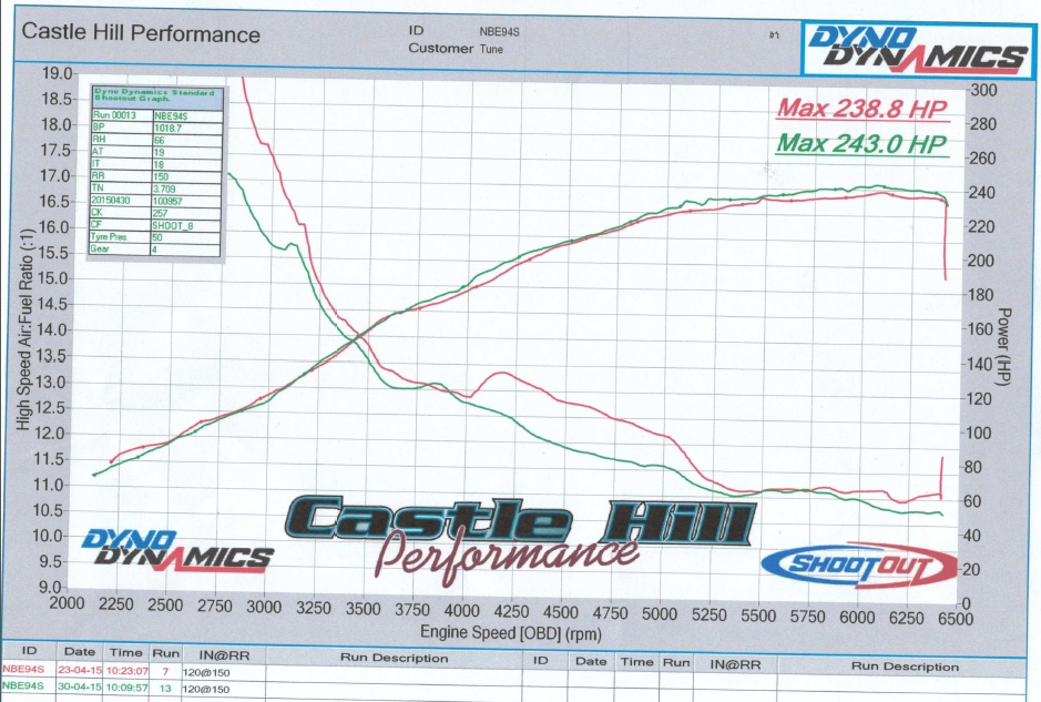

Here is a dyno run with AFR plots from a 4.2L N/A XJ
Both runs are with 100 cell cats fitted. The red run is with minicats on the downstream sensors, the green run is with the minicats removed and Euro2 emissions settings.
You can see the lean patch on the red run, just after the transition to WOT. The minicats slow down the response time of the rear sensors, so the ECU can't get the fuelling right.
In addition to this, the owner of that car reported a major improvement to his highway economy, dropping from 9.8L/100km to 9.2L/100km, it was also evident on the tailpipes of the car, with the minicats the tailpipes would soot up quite quickly, with them gone the pipes were much cleaner.
