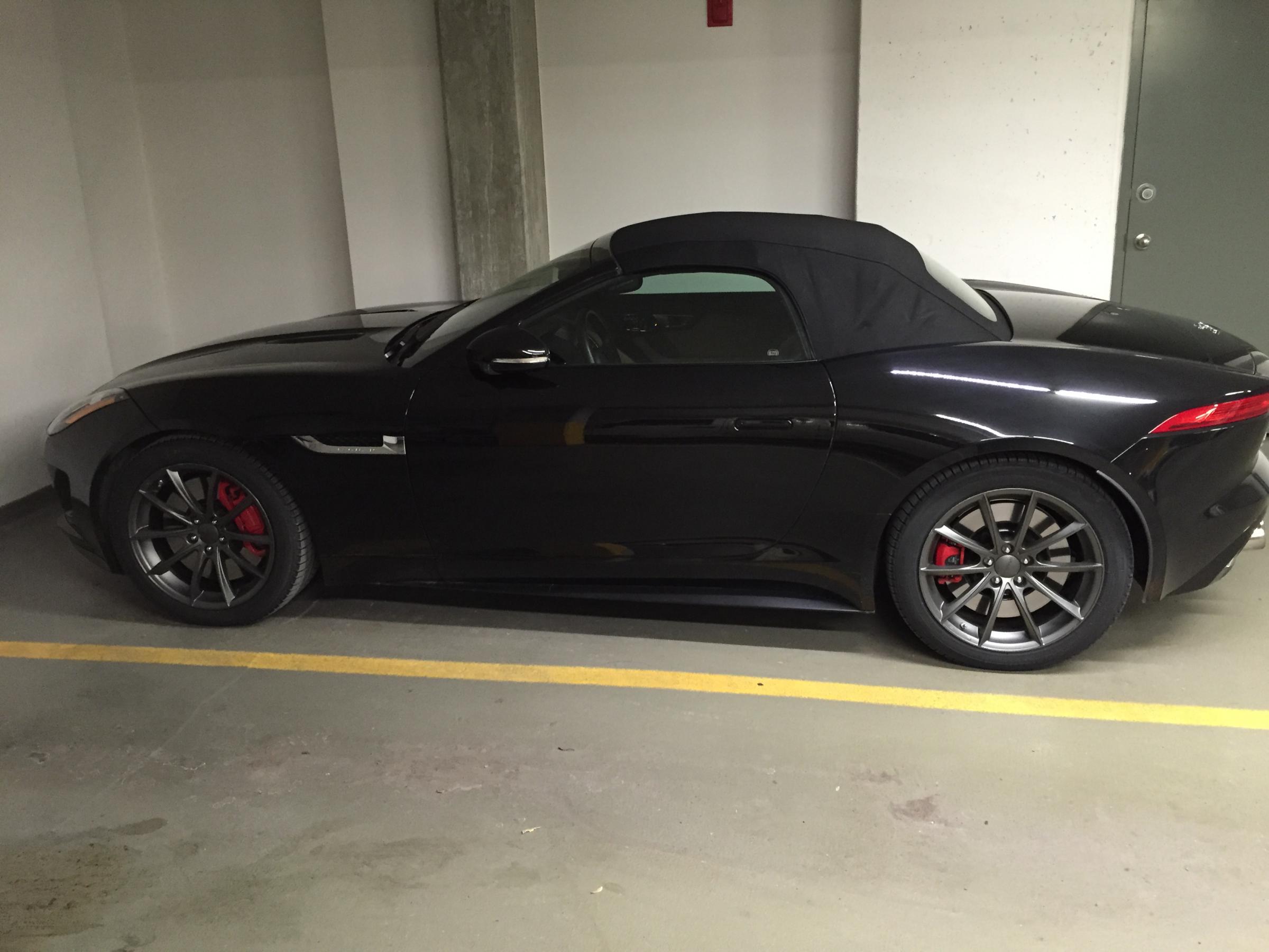

Had my F-Type V8s since March, and as everyone might guess, I absolutely love it. As everyone knows, it's an amazing car in the summer. My previous car was an S5 cab, and it made me a big fan of having a convertible year round, if there is sun out the top is down, even if it's -20ēC. Crank the heat, turn on the steering wheel heater and seat heater and you're enjoying the few moments of sun that we get up north in the winter. So I knew I had to find a way to run the F-Type year round.
It took a while to get my setup down as no dealer or forum had any information for me regarding winter in the F-Type. They recommended storing the car or putting sottozeros on stock rims. Now I knew that having 295s in the back with performance winter tires would be a recipe for disaster. (wide tires float on snow)
I decided on putting true snow/ice tires and not performance winters on. 245/45/19 would be the narrowest/smallest I could get around the big brakes. I ended up getting rims made with the following specs for all 4 corners: 8.5inch x 19inch, with a 5x108mm bolt pattern, and a 45-offset I moved the rims inwards by 1inch to prevent stone spray on the body. Wrapped them with Michelin X-Ice 3s.
In Montreal we get a lot of snow, from November-April so I was a bit nervous not having the quattro system, but i've been pleasantly surprised! We've received a few days of snow, and i've driven over 1000km in winter weather without any problems.
The real test came yesterday, a foot of snow fell while I was parked in an un-plowed parking lot. The F-Type got out without any trouble and then handled the drive home and through a 2 foot snowbank into the garage. The snow mode, traction control and locking diff really handle snow and ice incredibly well.
Of course having 495hp to the rear wheels on snow means you can really have some fun as soon as you turn off the TC and return the car to regular or dynamic mode!
Anyone hesitating with using the F-Type year round? Go for it! Follow my setup and you'll be able to enjoy your car all that much more.

It's rare enough to see another f-type in Montreal, let alone winter, we may be the only ones...
The 245 snows definitely do not feel like stock, but i'm alright with that as they get me up north and back!
