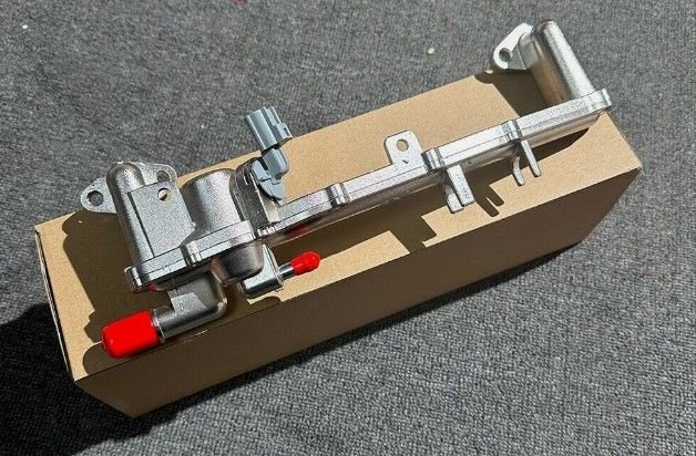

Well I'm sure you've seen some of videos on my Xf Cooling pipes upgrade to metaI, if you haven't seen them here they are, but my main reason I'm here I'm installing the rear metal pipe on a 2018 F-type R on one of members car and I'll be posting it here step by step video,he wants the Supercharger Coupler done to so it's an entire video overhaul
the new pipes for the V8 is here
Link here
https://euro-amp.com/products/land-r...ine-s-c-or-n-a

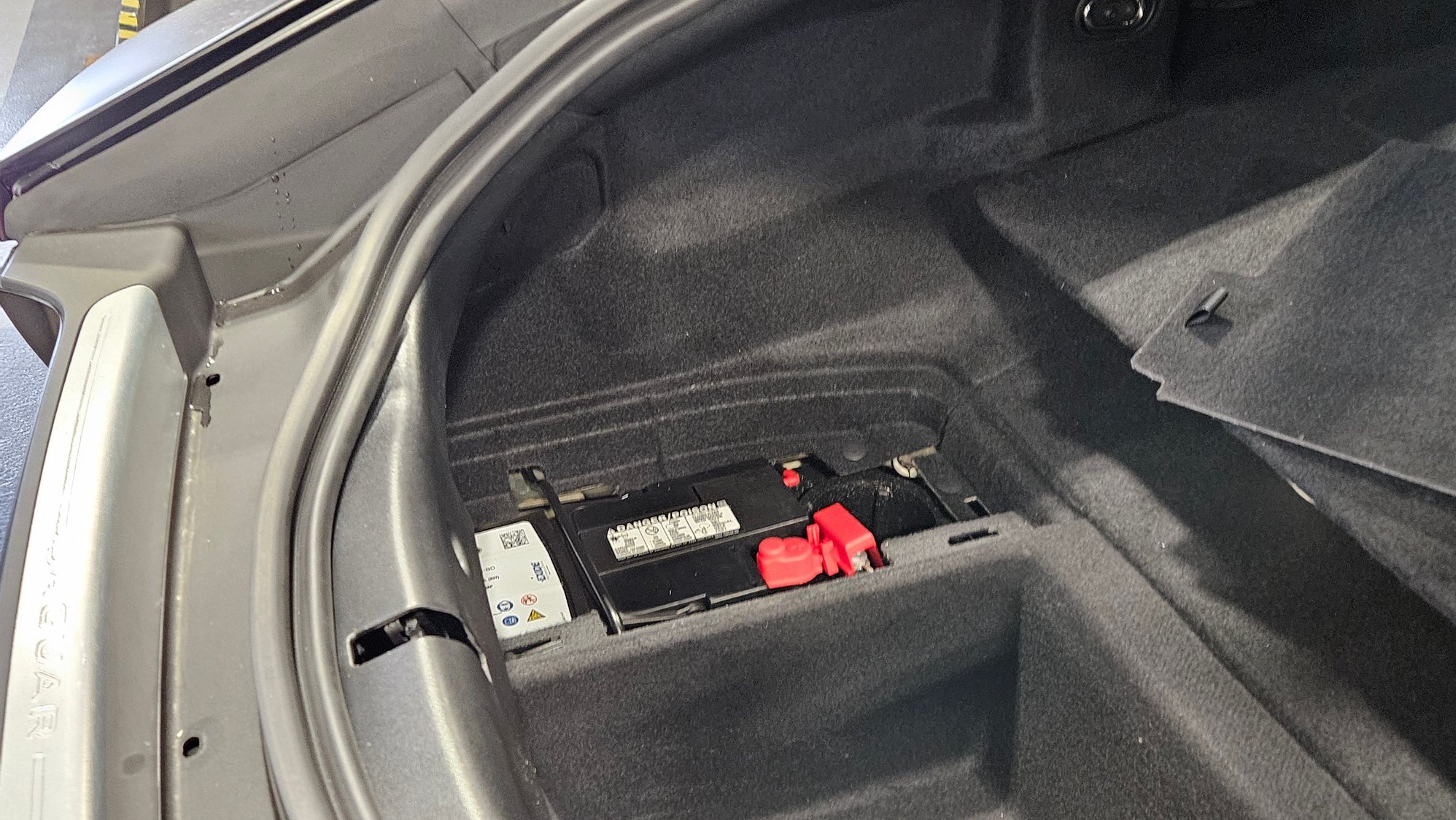

Just an added note get a icarsoft v3 to check your battery and do resets etc, your battery has to be at tip top shape, to keep the modules at 100%

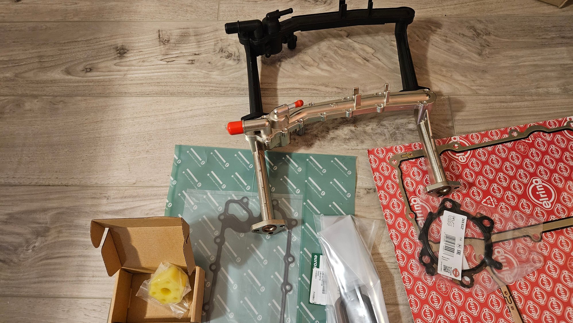

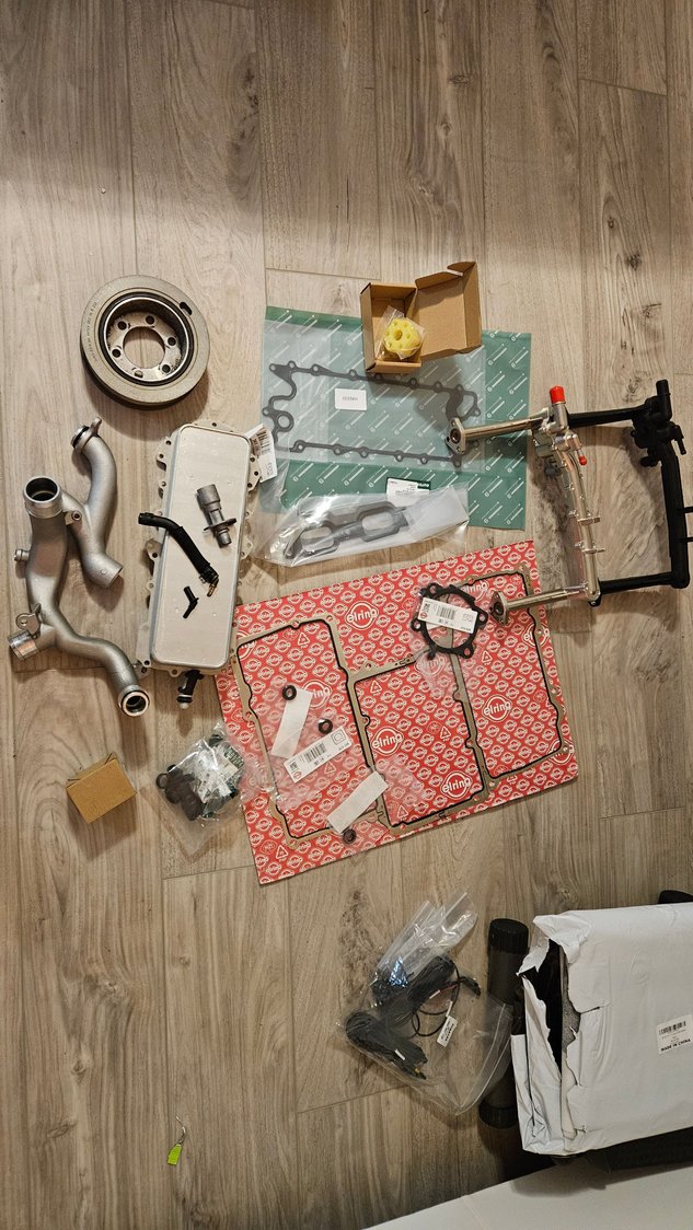

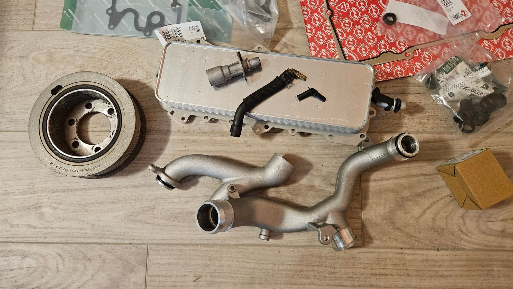

Old Apr 21, 2024 | 03:22 PM
dennis black's Avatar
Joined: May 2006
Posts: 2,033
Likes: 585
From: connecticut
more pics
Old Apr 21, 2024 | 09:34 PM
Joined: May 2006
Posts: 2,033
Likes: 585
From: connecticut
Parts came in for the 2016 F-type 3.0 v6 also another overhaul
