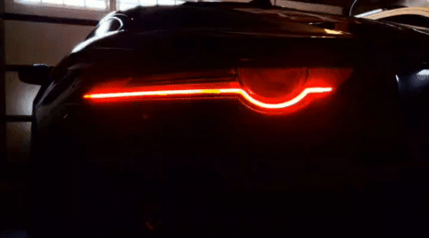

Can you post some pictures of the E code tail lights?
I’m lost as to what they look like.
Thanks!
They are the tinted facelift variety, which look much better than the previous generation of tail lights. What makes them E-codes are the amber turn signals.
I will do you one better:
Those look fantastic! I’ll be adding that to
my mod list when I get my F Type
What is the part number/how would I know that ordered the right tail light assembly.
I bought both of mine from salvaged UK cars. EBay UK and EU are great sources. I paid less than $90 per light, which is absurd compared to what the e-codes on my Audi and Porsche cost me.
Euro Spec Part Numbers: LH T2R24155 & RH T2R24154
The listings often have incorrect part numbers, so I recommend verifying the part number on the sticker or asking the seller for a photo of it.
Good luck, and let me know if you need any further info.
