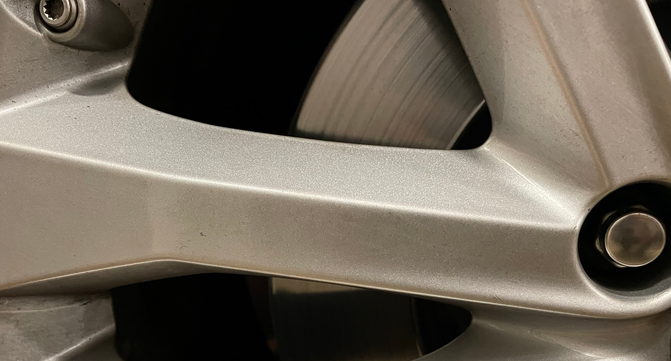

How about providing a picture of the rotor in question?
Here's our base model's fronts, after 35,000 miles. These grooves do NOT indicate any need for replacement IMO.
