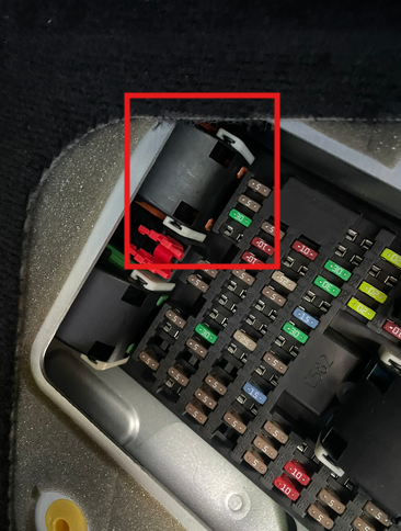

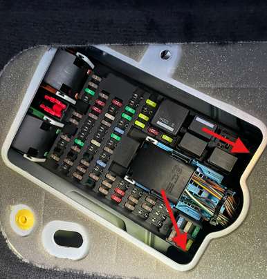

Who designed the F-Type vert??????? GRRR
Couldn't release the black cover because it is under the edge of the access hole.
The black cover needs to pivot up to the right.
The 10mm nuts holding the fuse panel are indicated by arrows. But the panel will not move to the right enough to release the indicated cover.
I used my formidable arsenal of wobble extensions and magnetic hut drivers to release the two nuts securing the fuse holder. <<SIGH>>

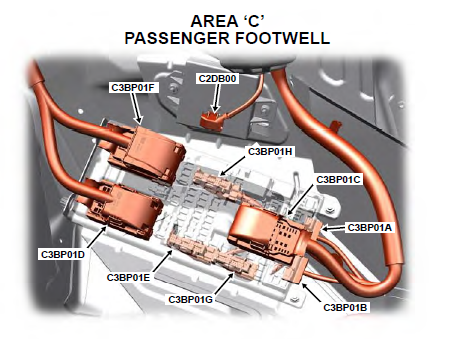

As I recall, you can power the solenoid directly from a wiring harness connector in the left footwell area. I remember a thread that told which wire it was.
From a quick check of docs I've collected here, I think that 12V applied to to C3BP01FR-6 will activate the latch release. Black wire, connector in Area "C" passenger footwell. Proceed with appropriate caution.

The immediate issue is that I cannot access the connector under the passenger footwell because the fuse panel cannot be moved far enough to the right to flip up the black cover. I have removed the 10mm nuts on the right, but the panel cannot be moved to the right enough to release the left-hand 'pins'.
If there is an alternate method or way to un-cover it, I would be most appreciative.
I've looked briefly to see if that surrounding floorboard panel can be removed or moved. Don't see any fasteners under the carpet..
