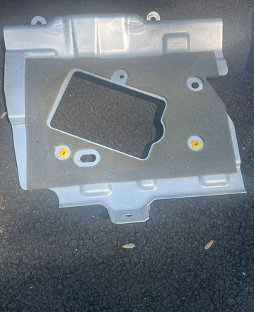

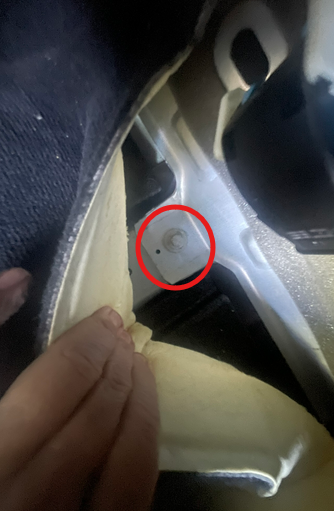

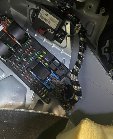

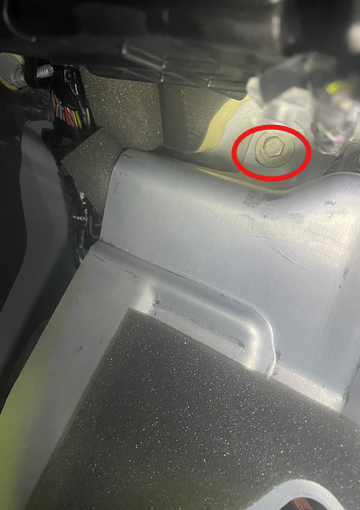

UPDATE:
The passenger floor around the CJB was put back into place yesterday. YOW that metal has sharp edges! Had to clean up the blood.
Pleased to report that I didn't drop any bolts, thanks to my magnetic 10mm nut drivers.
Here are some pictures of my 'lesson' in case someone else needs to remove the floorboard to power the trunk release.
The carpet is VERY stiff and difficult to pull back, to access the bottom 10mm bolt.
One of two upper 10mm bolts.
CJB fully exposed.
CJB fully exposed.
Floor panel out of the way

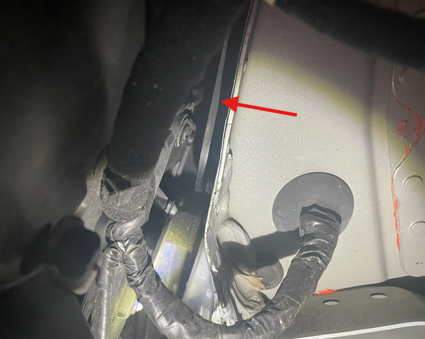

I DID find where the vents referenced by @Adam Deermann were located. You need to ID them by feel...this is all you can see from underneath.
The edge of the vent.

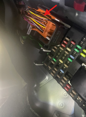

This picture sorta shows where the black wire is connected to the C3BP01F (upper-left) connector.
The wire was difficult to see, as it is just to the right of a black-with-white-stripe wire.
I put a small 12" long, insulated solid wire, into the backside of the connector, then all it took was a momentary connection to our 12V jump-box to release the boot.
Amazon Amazon
Be sure to squint!

Really appreciate the update and picture. I'm sure this will be helpful to all in the future. I assume you connected the wire to the red lead on the jump box, but did you have to connect the black lead to a ground on the body or just let it hang idle?
No Powah unless you hook the black clip to a ground! Just used one of the other bolt-heads that are visible in the pics.
As mentioned, it only required a momentary connection to release the trunk latch.
Multi-stranded wire was too 'pliable' for the jump-box's alligator clips to hold onto securely.
