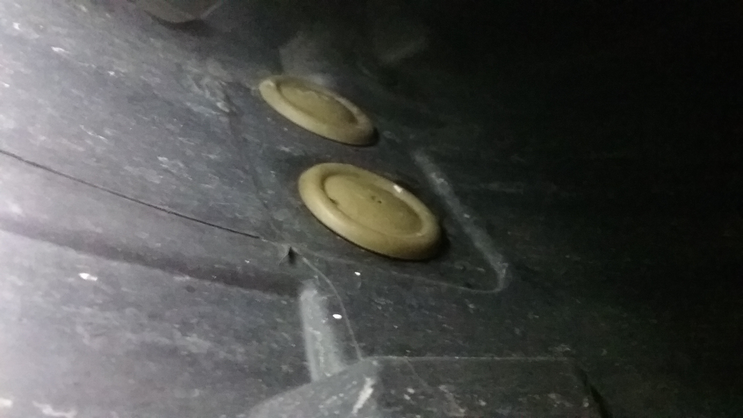

You can get at over the top of your tires. Just pop off the two round plastic covers... You can get the right size bolts at your local hardware store. Mine were off too. I forget the size of the bolts now, but I took one off of the connected side and took it with me to the store... Used a 10mm extended socket with quarter inch ratchet wrench... bolt was one inch long and had to use separate washer... On the Jag bolts the washer is connected to the bolt...

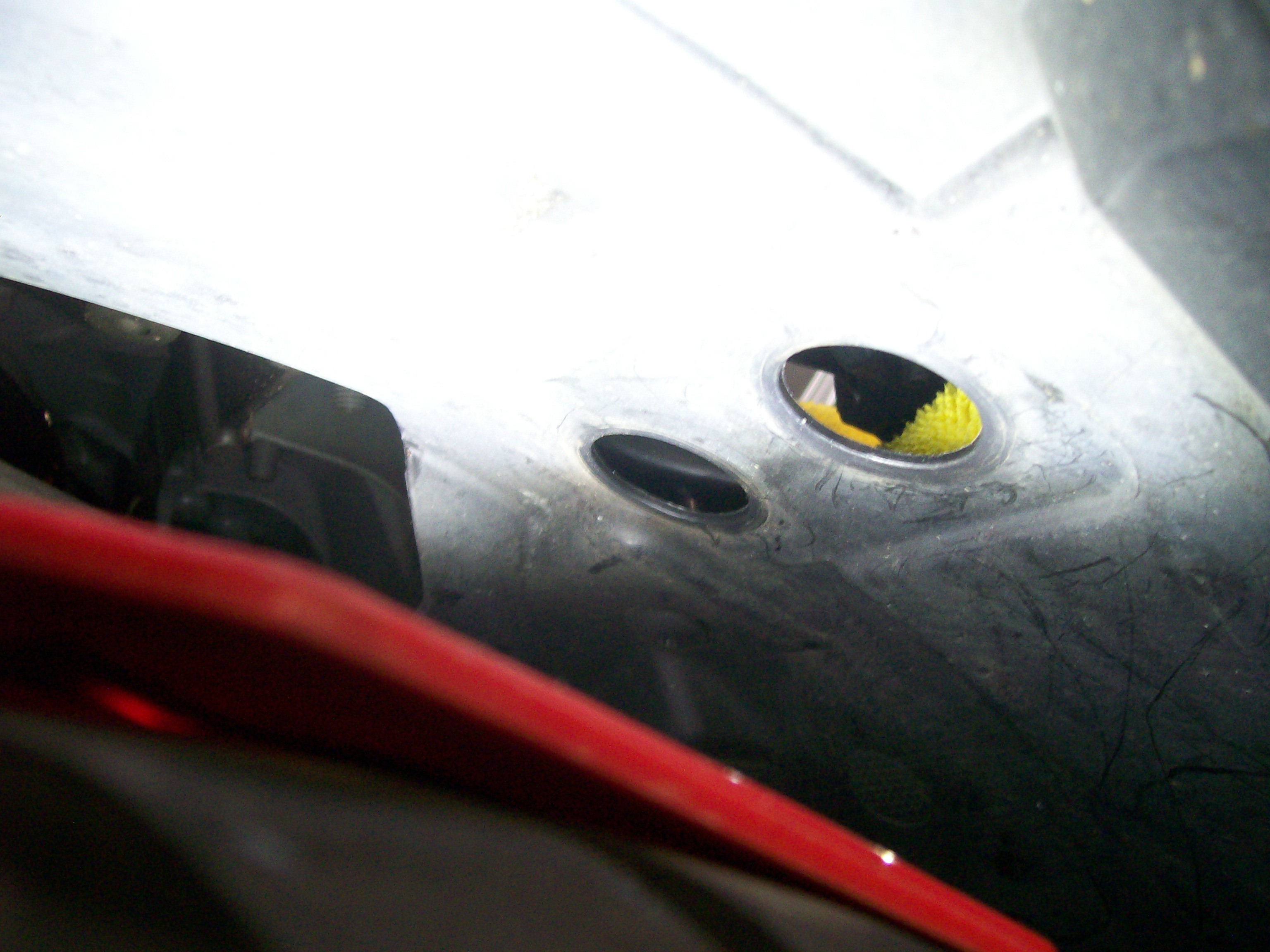

Default the headlight bolts
Be sure to stuff something down in front of those two holes, otherwise you risk losing one of them down that abyss called 'the front end'. I also used some Poster Putty to make sure the fender bolt did not escape from my socket. I had the same headlight assembly misalignment issue and both of those 'fender' bolts were missing. I don't think they were ever even there, as there was no indication of any marks from a previously tightened bolt that may have fallen out.
