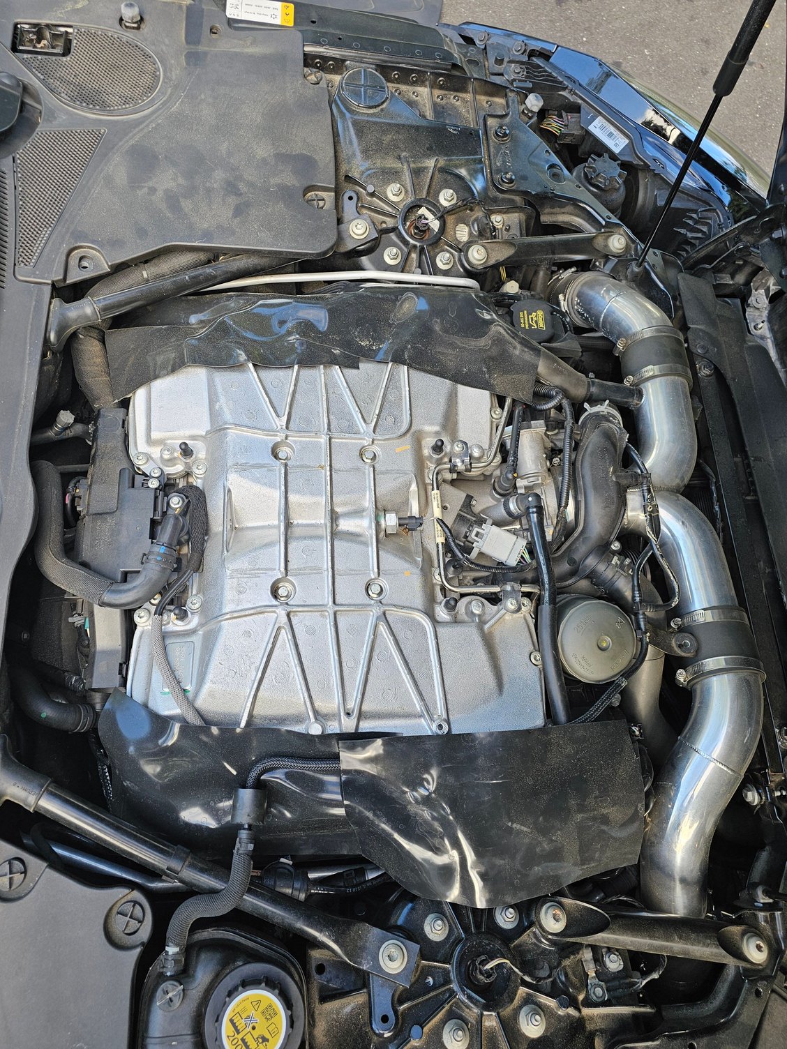

Hey @David993S and forum, this was originally a question asked by Dave but I thought I would share my borderline shameful looking but effective prevention of water ingress for my RWD R (applicable to any RWD car with the water ingress issues). 4 sheets of high temp silicon rubber with a slightly sticky backing placed under the engine cover and just enough to cover the "holes" where water can run down the side of the motor (and into certain injector locations). It ain't pretty but I threw it together when I knew I had to drive through rain (usually garage and sunshine only) a while back.
Hope some of you find this useful.

Better than the alternative!

Good solution. With the engine cover on, it's not objectionable. It's functional and removable if necessary.
Thanks.

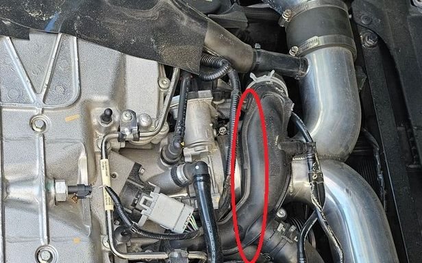

Surprised those fat seemed pipes have not failed yet?
I would plan to get those swapped out as they are a real failure prone setup!
The new plastic ones have no seem and of course the metal ones will solve all of that.
Surprised? Yep mine is a 2015, and about 36k miles, and plan on keeping them to ensure my car has maximum collectability.

Crap, I'm sorry, that was me being facetious to be clear, that is NOT a thing. It is a matter of time, these are wear items like most coolant system components. Even with those new metal pipes, eventually the rubber orings will fail (but not so early and dramatically). I actually am planning on having my cooling system refreshed in a few weeks. Just goes to show however, I have the "notorious" seamed pipes that are 10 years old on my car but they are holding.... now that I have put that out there I am sure they will fail tomorrow 😆

bfrank1972 makes a good point that if your aware of the potential problems and keep and eye on things you can catch it before it's a disaster. So many people never open the hood at all until they are on the side of the road with a blown up engine.
One suggestion is to at least run something that gives you the real coolant temperature. I have been using Torque Pro for years now.
Even those terrible fat seamed pipes usually start weeping at the seams long before it becomes a major leak. On my 2014 XJR at 29K miles when doing an oil change at the dealer they noticed this small weep and I got both front cooling pipes replaced under warranty. I still have plastic but smoothed seamed versions at the front of the engine.
