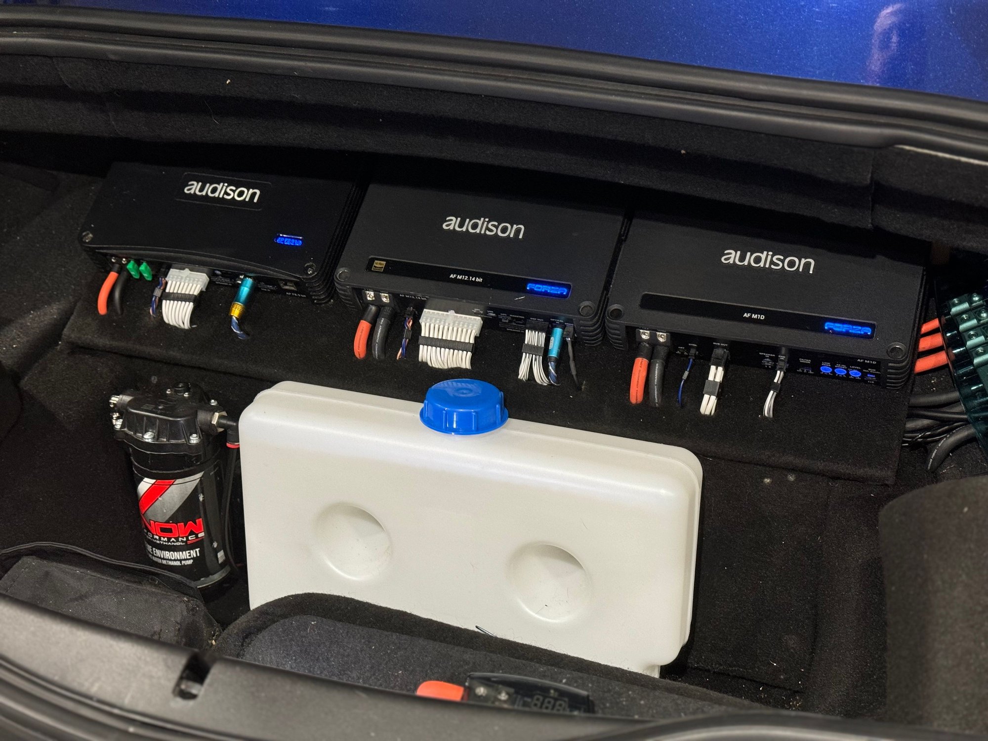

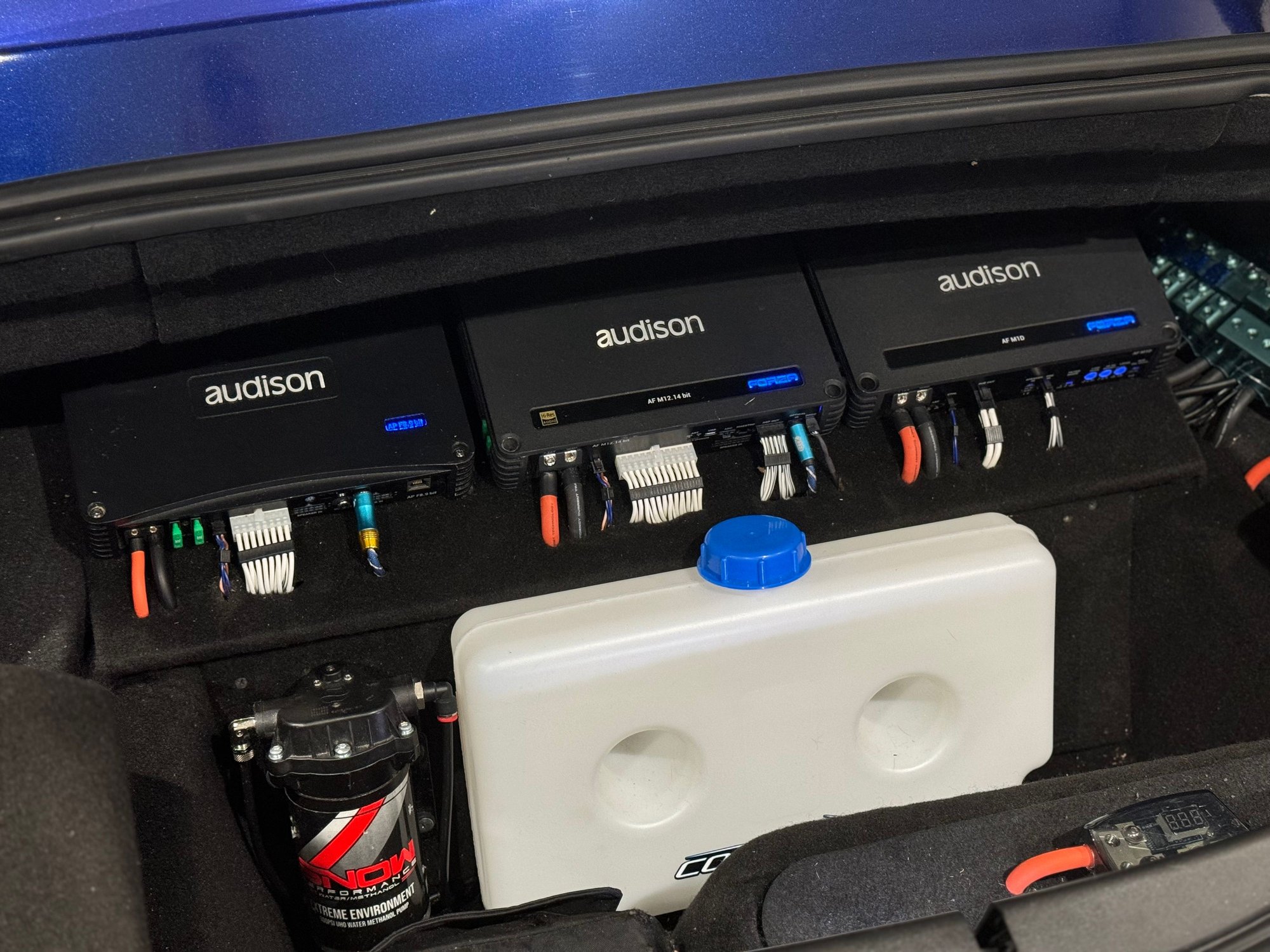

For real bass you need a dedicated sub
for coupe the wheel well is ideal
mine is soft top so I had 2 enclosures for Jl 6.5 subs left and right with their own amp
audison m12 all bridged for fronts
with dap out signal feeding
audison 1.500 for 2 Jl subs
rear m8 again bridged for 2 woofers and rest for mids and tweeters
the interface has 2 signal out so one for the fronts and one for the rears

i run the unit to Audison 12 Chanel and 8 Chanel all bridged
the ded has a front and rear output I then use the 2 dsp channels to run my Audison sr 1.500 for two jl subs
if ur in the uk drop me a message and I will give u my tel no

My final version
added the Addison m1d so I can runs the subs via the m12 dsp and also control their volume by the drc
