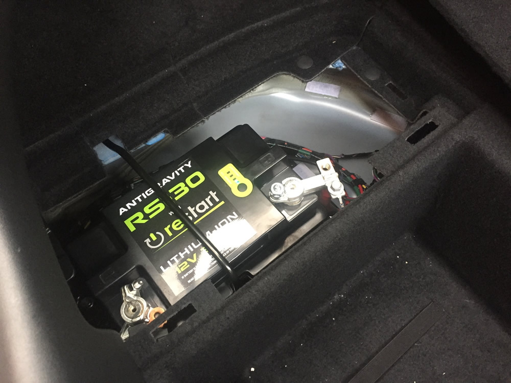

My RS30 is fitted.
Stock battery in my car was 25.9kg, the RS30 weighed in at 4.6kg.
I left stock tray fitted, I also put a layer of sticky back velcro on the tray and the opposite velcro with sticky back to underside of battery. This velcro helps hold the battery in possition.
As the other forum memory, negative terminal is a hair to small, I use cut a small section of Jubilee clip and wedged it in making the negative lead nice and tight.
As I really wanted to make the battery as secure as stock, I also used some washers to marginally raise the height of the battery retaining brace, which worked a treat, its now impossible to move the battery as its braced into position using the steel rod that bolts to the battery tray and the velcro for good measure.
Removed the tyre gunk, only other issue the towing hook/eye for recovered now no longer sits next to battery so need to find a new home for it.

Mine installed using original tray and bracket, its going nowhere.

Gibbo, you win. The AG battery is a full half inch taller than the OEM battery, and too tall to permit anything other than the OEM tray to be installed. I have employed the same installation methodology as you, and will have pics later today. They won’t look much different than yours. The retaining Rod, however, does require a 1/2 inch spacer at the bottom with a 10mm longer bolt.
