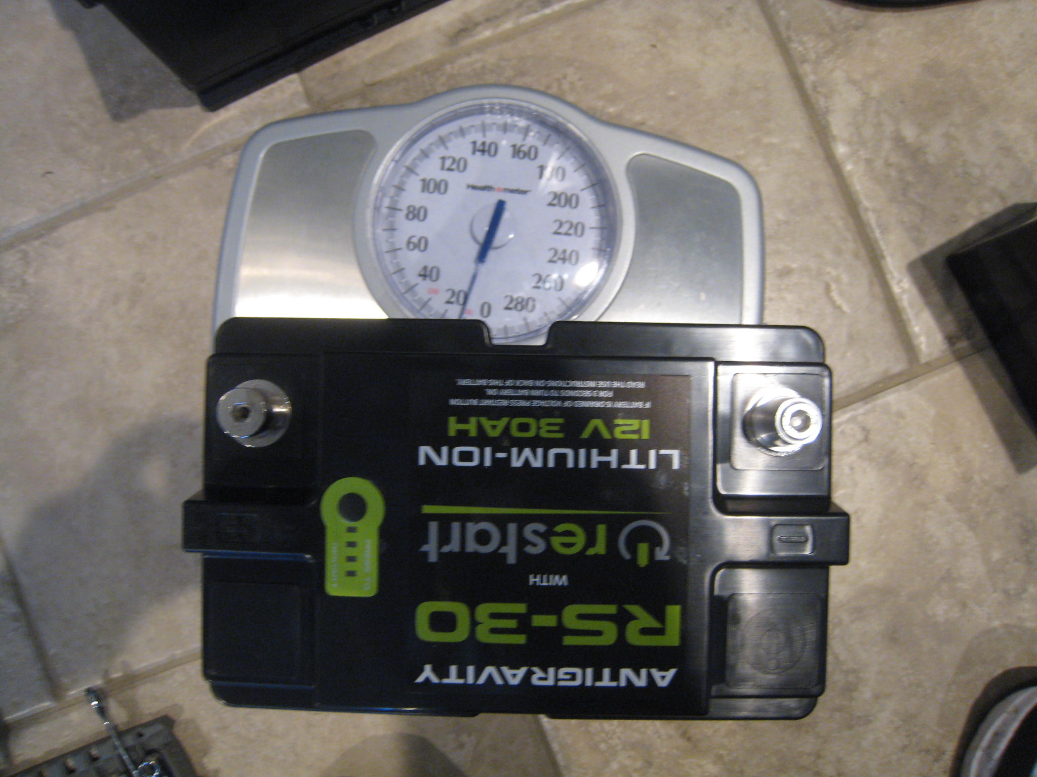

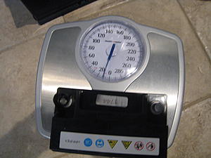

My stock battery weighed 25.9kg on my scales, the RS30 was 4.6kg so the saving is good. I also removed the tyre gel, the inflator and have not bothered with the lid to battery compartment, just kept the main cover. As such I am about 25kg out the car from battery swap.

Installed my RS-30 today. 30 mins, using velcro, longer bolt and 3/8 inch spacer and installed without issue. Came with 2 sizes of negative terminal posts, the larger one was perfect for the F type. Ridiculously lightweight, restart technology, and cool LED status lights, almost seems worth the price of entry.
As a bonus, for those with 2015 models, its worthy to note that the silly eco stop start battery weighs almost the same as the new antigravity starter battery, which means I effectively removed the entire 58lb weight of the factory starter battery from my car with one simple upgrade!
Can't wait for the new lightweight rotors (-50lbs), combined with existing forged wheels (-40lbs), battery (-55 lbs) VAP springs and exhaust (-20 lbs) engine cover/misc (-10lbs) my car will be down from 3850 to 3675 lbs. Still too heavy, but 605 horsepower can make up for at least some of that excess weight
