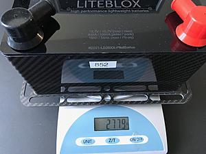

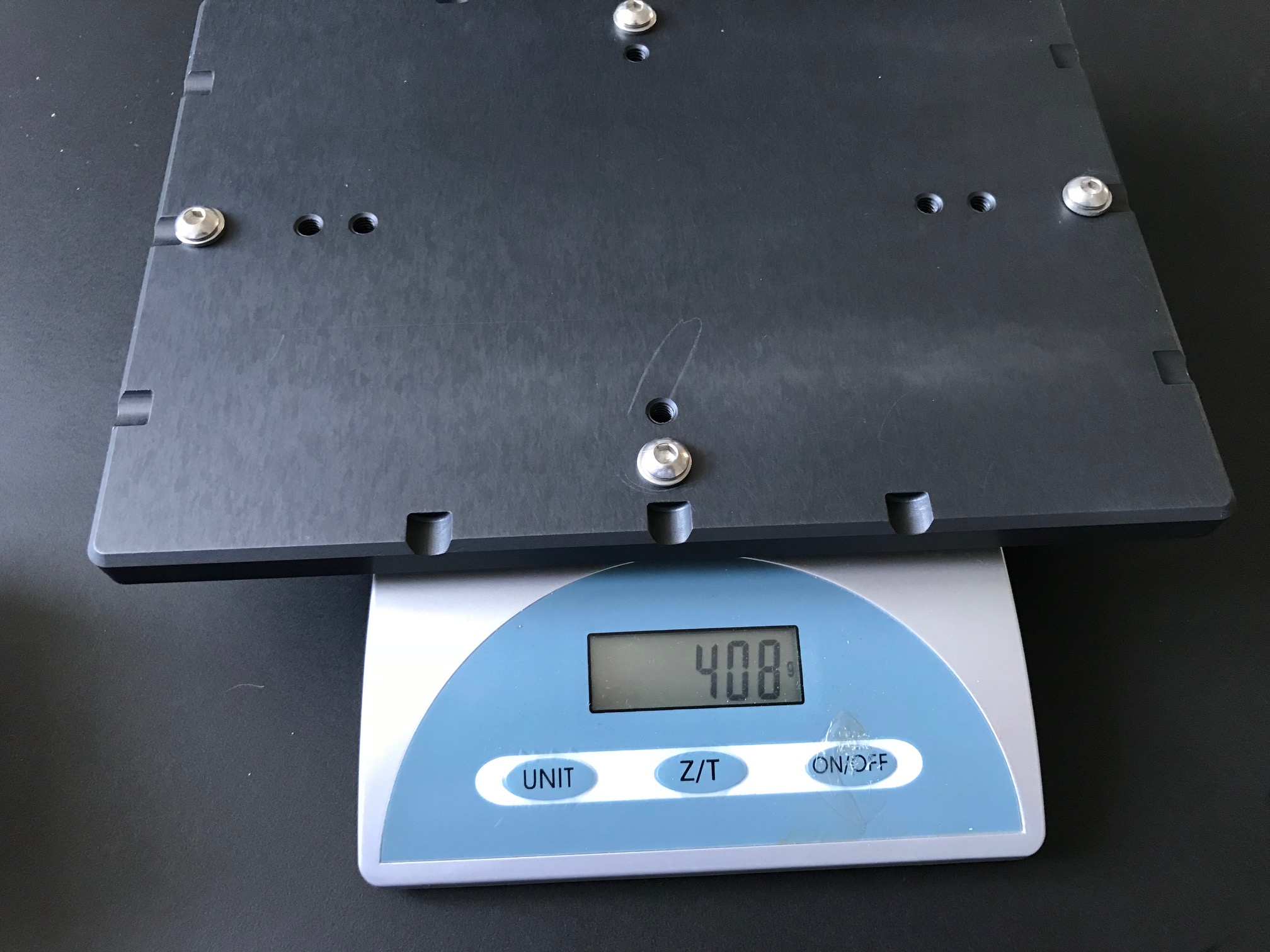

Old May 4, 2018 | 07:22 AM
  #160
F-Type-Type's Avatar
Joined: Feb 2018
Posts: 144
Likes: 35
From: Gentofte, Denmark
Default Litblox battery received
The LiteBlox battey just arrived. Placed it on the scale to find out that it's slightly heavier than promised, but I think the exces 200 g (0.5lbs for those that still dont agree with Napoleon) isn't going to tip the scales - see pictures. Was a piece of cake to hook it up to the app on the iPhone, which provides status of each cell and the total battery and gives the possibility for de-activating the battery as an antitheft measure.
Gonna install it over the weekend and will let you know how that goes and how the battery functions in daily driving.
Attached Thumbnails Group Buy: Lithium-Ion Battery-img_2880.jpg   Group Buy: Lithium-Ion Battery-img_2879.jpg   Group Buy: Lithium-Ion Battery-img_2877.jpg
