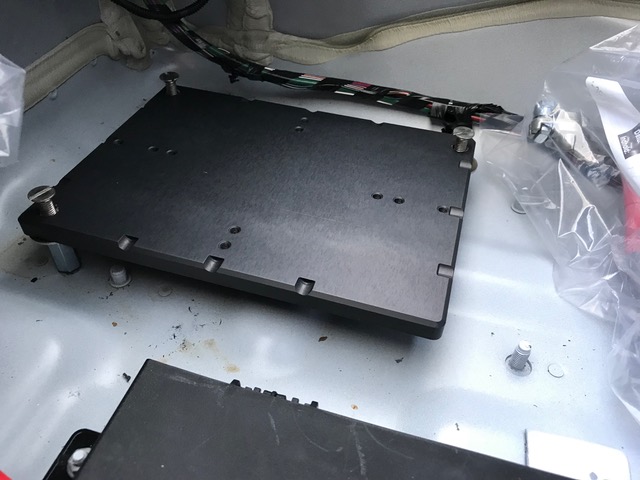

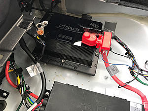

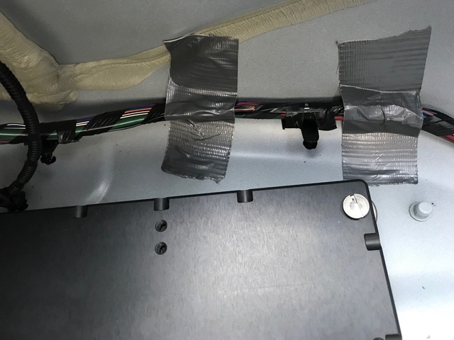

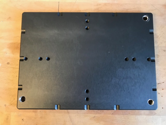

Installed the Liteblox battery yesterday. Mounted absolutely clean to the trunk with the universal adaptor plate supplied by Liteblox.

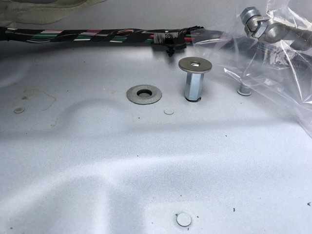

I used three of the four upwardly directed threaded studs on trunk floor, in the way proposed by Unhinged with M8 connecting nuts and M8 bolts through holes that I drilled and filed in the universal adaptor plate. The fourth stud was spaced to far apart from the others, the adaptor plate is quite small compared to the OEM battery tray. I placed washers between the connecting nuts and the bottom of the adaptor plate since the bottom surface of the adaptor plate is uneven (bottom is milled out so there is a rim around the outer edge). The install is very clean and stable and relatively easy, took me less than 2 hours and I took my time and took a few pictures in the process that are attached
I had hoped that I could countersunk the flat head bolts completely level with the upper surface of the adaptor plate, but that turned out to challenging since the holes needed to be placed right at the edges of the adaptor plate. That meant that the mounting bracket at the bottom of the LiteBlox battery was at three corners resting on the elevated flat heads and the medially arranged bolts that secure the battery to the adaptor plate would bend the (carbon) bottom plate of the battery. I did not want to expose the battery housing to such stresses so I took a hacksaw ad removed the excess bracket/bottom plate material from the corners (used a file round off the sharp edges left by the hacksaw). Surprisingly easy and neat to cut through carbon with a hacksaw. I plan to replace the ugly flat head bolts with black hex bolts, just for looks.
Thus, the adaptor plate is well secured to the trunk with three M8 bots and given the ridiculously low weight of the LiteBlox compared to the OEM arrangement the connection is likely to be heavily overdimensionned.

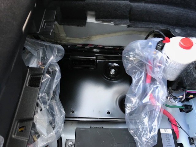

The OEM battery tray is used to secured the portion of the cable boom going to the rear end of the car. The LiteBlox adaptor plate is much smaller so the side of the adaptor plate is too far from the cable boom to support it (as was my original plan). To avoid that the cables rub and wear out against the trunk floor I have now ducktaped them to the trunk floor but I am not particularly proud of the part of my install. Does any of you have a better idea for securing the cable boom?
Fitting the clamps to the terminals completely straight forward. My only worry was the length of the cable connecting the clamp to the fuse box, it is only just long enough due to the Liteblox being so much shorter than the OEM battery and the plus pole thus being placed more to the rear of the car.
The foam unit that holds the goey bottle is fixed only with Velrco but held in place by the OEM battery on one side. Without the OEM battery supporting it on one side I was afraid the foam unit could get loose and the bottle and the nutlock adaptor would be rolling around the trunk floor with all the electronics and cables - not good. So I added a cable binder to the top of the bottle and I am sure it will keep it in place.
I haven't found a neat way to fit the foam unit that holds the towing bolt, but will let you know when I do. This may take a little while because me and a buddy are working on a lightweight version of the towing bolt (more to come about that).
There is now quite a bit of extra space around the LiteBlox batter for fitting e.g. the tire pump, I am working on a neat way to secure the tire pump in this newly created space.
Car fired up without problems, had an engine fault light for the first two short drives (disappeared now) and needed to reconfigure date, time and other settings but otherwise no issues. It was easy to hook up the smartphone app to the battery to monitor it and to shut is down or turn it on (antitheft shut down).

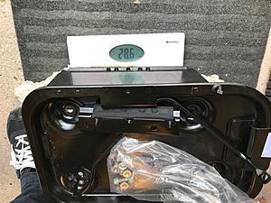

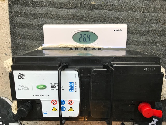

Weight saving more considerable than expected! OEM battery arrangement: 28.6 kg! (63lbs) Litblox 3.2 kg (7lbs). saved 25.4kg (56lbs).
Will be interesting to see how well the new battery charges in daily driving! I will take a screenshot of the batter condition every day the coming two weeks. I expect quite a few days with short drives only so that should be a good test. Let me know if you have any questions.
