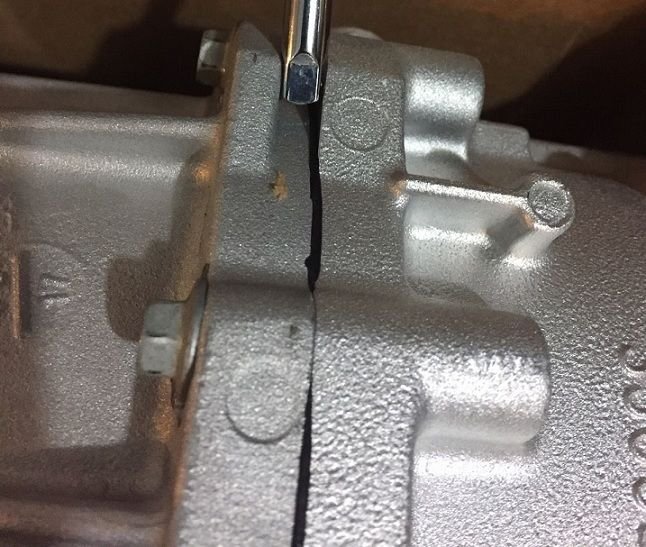

Trying to remove the snout, anyone know a good way to remove it without damaging the snout?
Cannot see a good way to do it, without sticking a big screwdriver between the snout and the supercharger.

A little prying is necessary - (1:30) of this video:

Yes Jaguar and Eaton put a spot to pry the snout off the SC. It's on the bottom so you can't see it very well when it's in the car.
