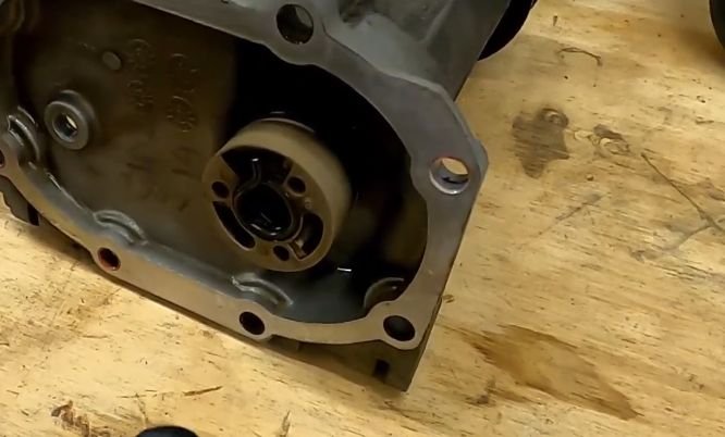

THE COUPLER HAS FAILED!!!!!!!!!!!!
No oil change will repair the broken coupler.
That would be this piece correct? (Photo from YouTube video not mine)
Would it be as simple as replacing just that?

The coupler is a plastic piece with a spring. The spring sometimes breaks and the coupler can rattle.
