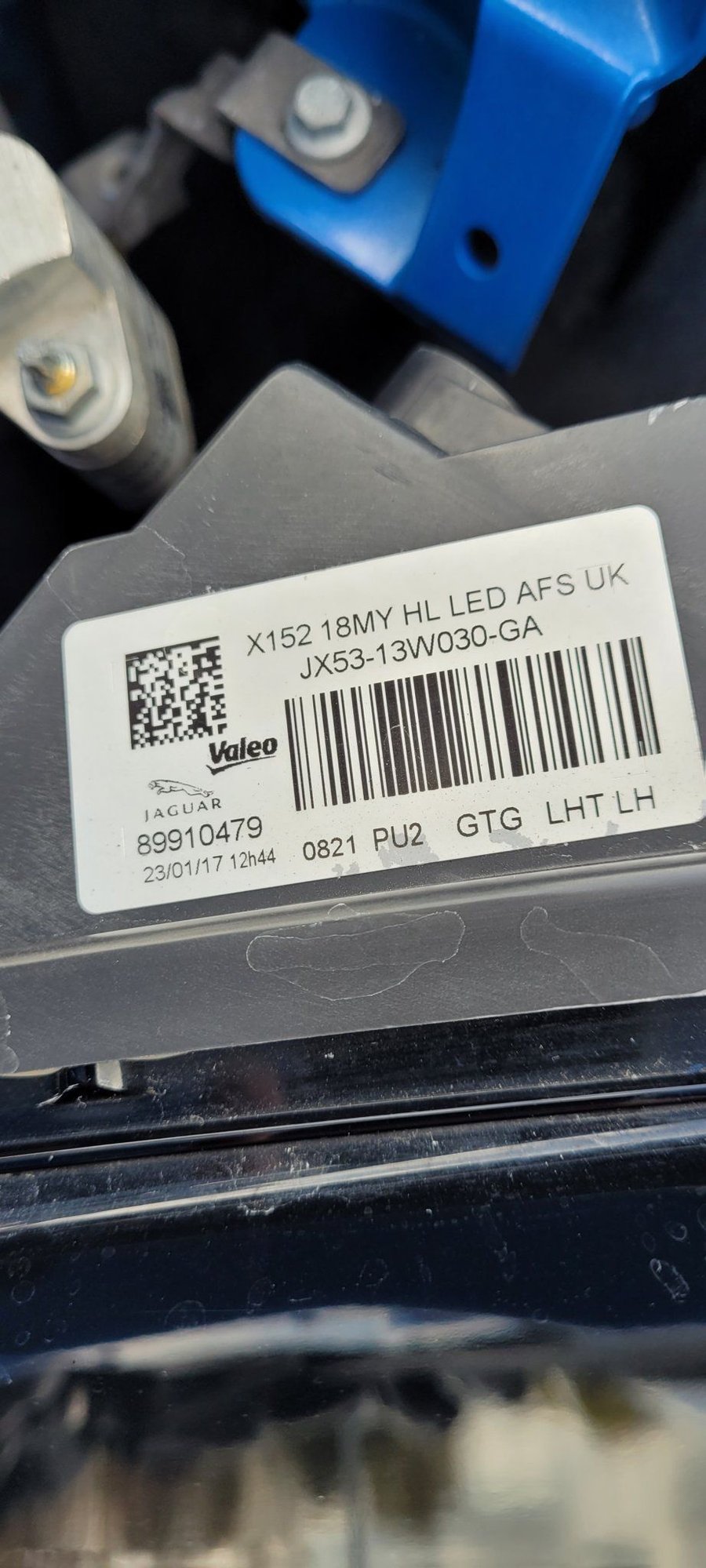

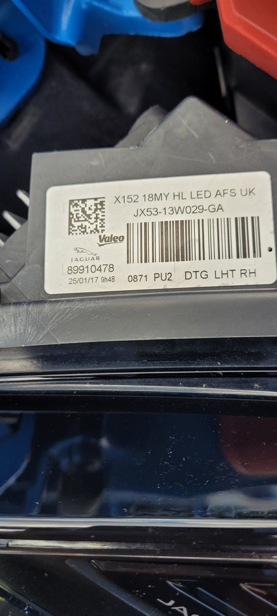

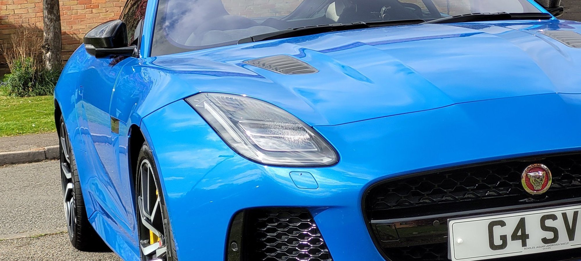

My car seems t have problems with micro cracking in the middle of the plastic lenses , not surface fogging.
This is the Auto focus type, with Auto dip , and the cracking in the perspex is dazzling oncoming drivers. Trying to get Jaguar to accept this fault. Its BOTH headlights.

I always thought Ultra Violet caused misting of the surface. This isnt like that , its cracks inbetween the outer surfaces of the plastic ( not on the surface ).
It looks like a manufacturing problem where they have moulded the lenses ( both sides ) and the plastic has been held in tension , as the heat changes the plastic forms minute micro cracks inside the plastic.
Over time these cracks are joining up and growing together.
These cracks then distort the headlamp light beam when in use , blinding oncoming drivers.....
the car has just 11,000 miles on it....
If you look from certain angles , you CAN'T see the micro cracks, then move angle by just a few degrees and there are millions of tiny cracks.
Ill take some more pictures tomorrow ( if you get the same thread of XFR haze of the perspex its not like that ie surface misting versus micro cracking of the inner plastic substrate )
