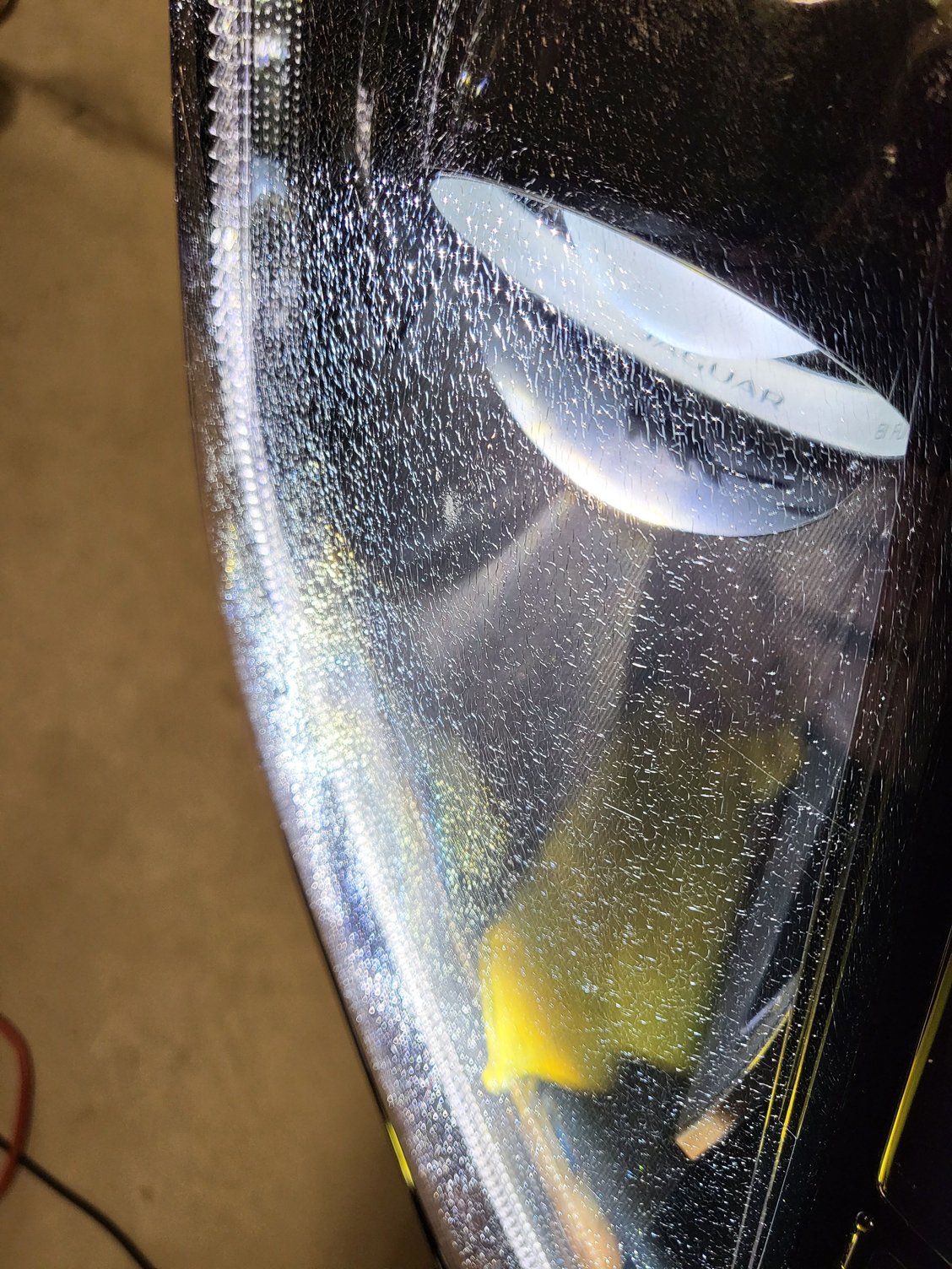

My 400 Sport has microcracking in both headlights extending halfway down the light over the LED. It isn't super noticeable when the lights are not on but very apparent when they are. The car is under CPO warranty and I have contacted a dealer but they have not responded. Has anyone else had this issue and was it covered by CPO in the U.S? Also, the J blade LED is only illuminating a few inches of the driver's side headlight. Is this a bulb/LED issue, or something more?
I finally heard back from the local JLR dealer and they tell me that the headlight with the faulty J blade LED will be covered under the CPO but they will not cover the other headlight for micro-cracking. My concern is with replacing just one headlight, will the other appear even worse than it already does; microcracks more apparent and even a possible brightness difference? CPO is clearly a different warranty but I feel like this issue isn't isolated and headlights should match.

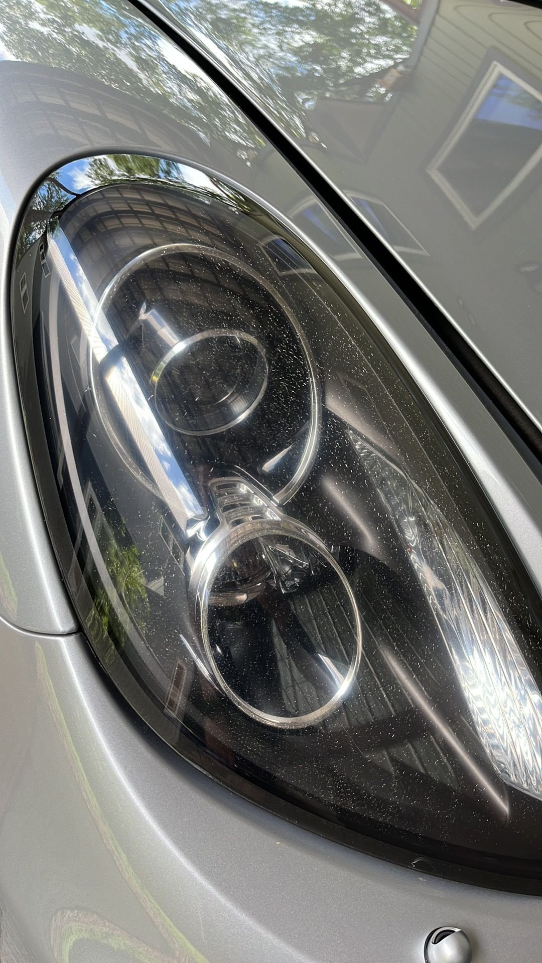

My 400 has very, very early onset of this. When it happened in my 981 Cayman, it started out very small and completely covered both lenses within 2 days of the southern heat. I am out of warranty and my extended warranty doesn't cover the lamps, so I am going to try some Lamin-X protective film. I'll report back as I don't really want to spend $5k a piece for lights LOL.

My P-car had no ppf on the lamps and this is how they ended up before I replaced them, so I can't speak to if ppf would make it worse. This was 100% within the lens as I own a body shop and sanded them down to clear coat them with unfortunately no improvement.

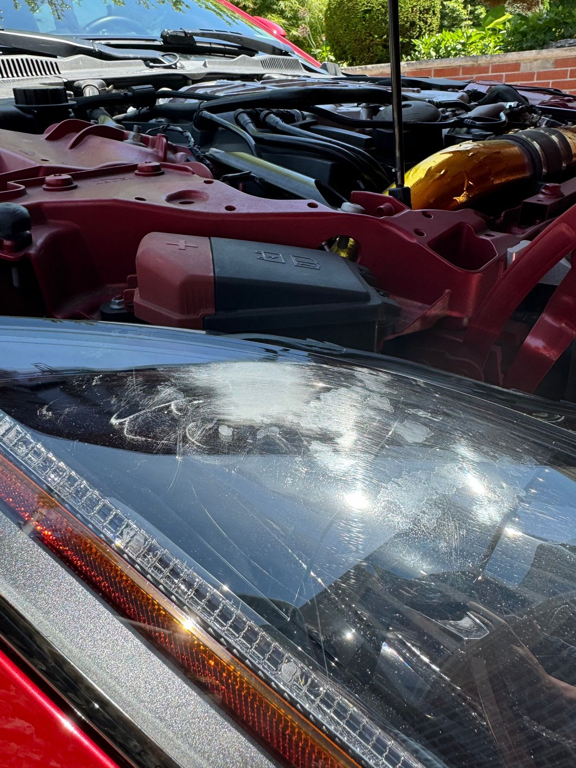

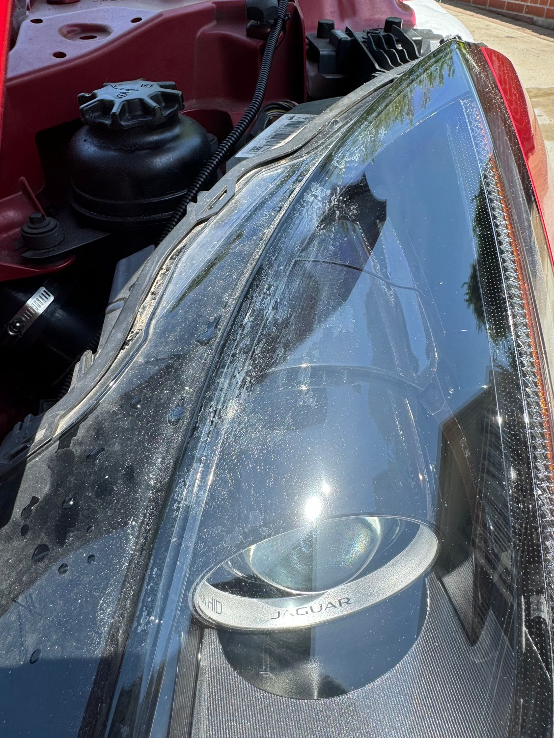

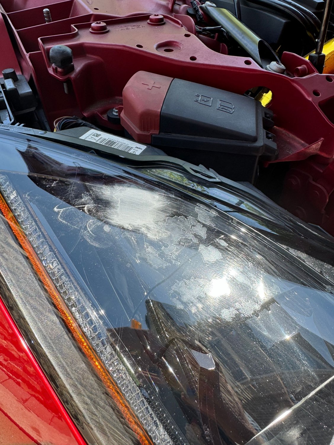

The cancer has spread to mine, seemingly over night, started to notice a cluster of stain looking spots last month, did not think much of it, but it did not disappear after a car wash, tried to clean them thinking it might be tree sap or stubborn grime, made it way worse in the process(or not, it was probably going to flake off soon without action)
After trying to sand and polish them, i realized it’s both inside and out, the inside is not that bad so i never noticed it.
Micro cracks is also visible when viewed closely or against the sun, similar to op’s picture.
the last 2 pictures has sanded spots on the top and untreated spots in the bottom, 1500 grit sand paper did not remove it fast enough, had to go for 800 for anything meaningful.

I installed PPF on my old S-Type head lights after I had sanded and buffed them back to perfection. Two reasons?
1. As posted above impact protection
2. All factory head lights have a UV coating on them. When you sand and buff the surface your removing that usually all of it. As I found that coating is what's failing and turning cloudy/yellow. I used Expel cut to size head light film. The film supposedly has UV protection. If you don't put some kind of UV protection on the newly cut and buffed lights they start to decay fairly fast. I have shot clear on them and used the PPF. The film is a lot easier to do.
Drove that car for several more years with no problems so I did not see any trapped heat problems from the PPF film.

The micro-cracking occuring on my 2018 are forming inside the lens, so no amount of sanding will fix it.
My CPO warranty will not cover replacement as I'm told this is a cosmetic issue (until it isn't).
I reached out to JLR customer support and they acted concerned and told me they would start a case to get me goodwill funding to replace. After waiting 2 weeks they informed me it's cosmetic and won't be offering any funds to replace.
So I've settled to having the driver's side headlight with the J-blade out replaced under CPO warranty and let the other one be. Hopefully it won't be a jarring difference.
