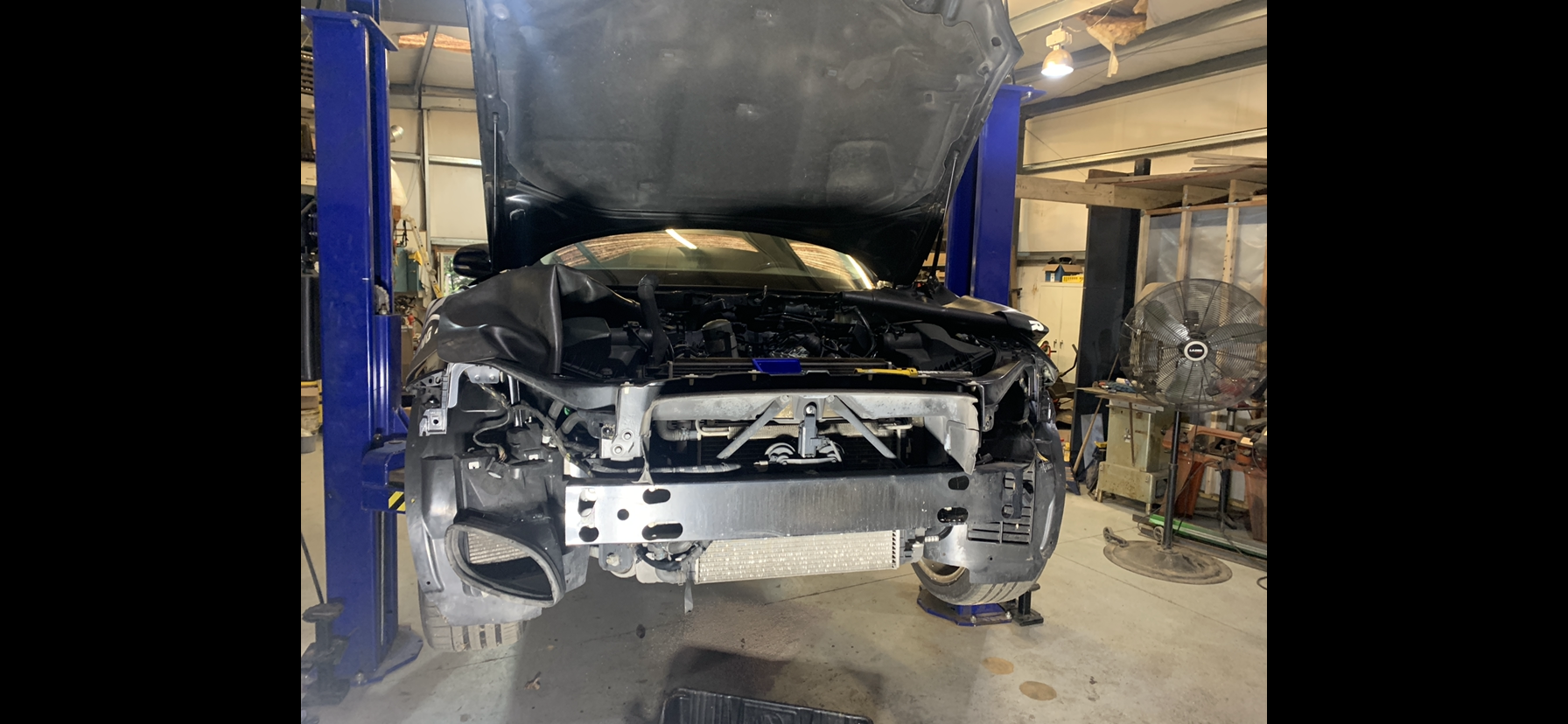

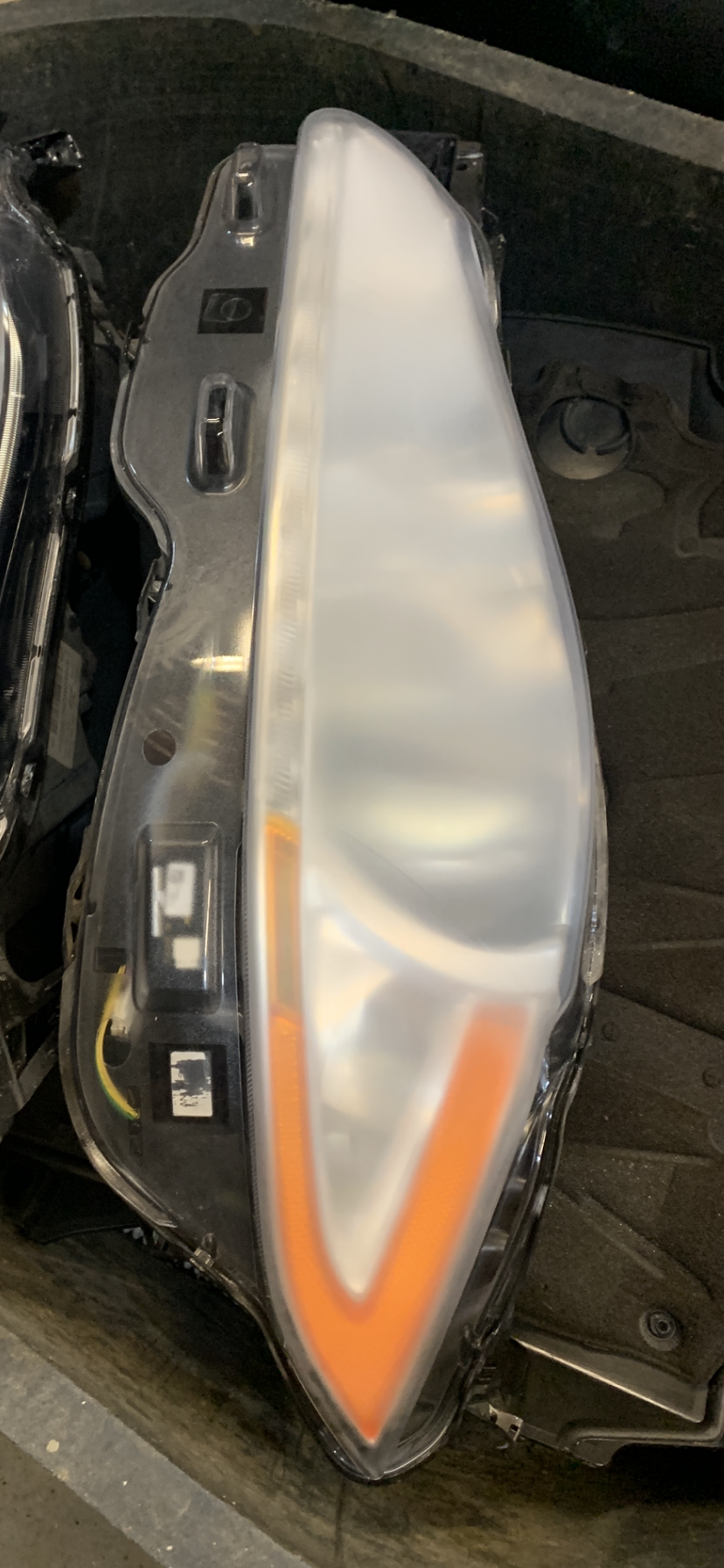

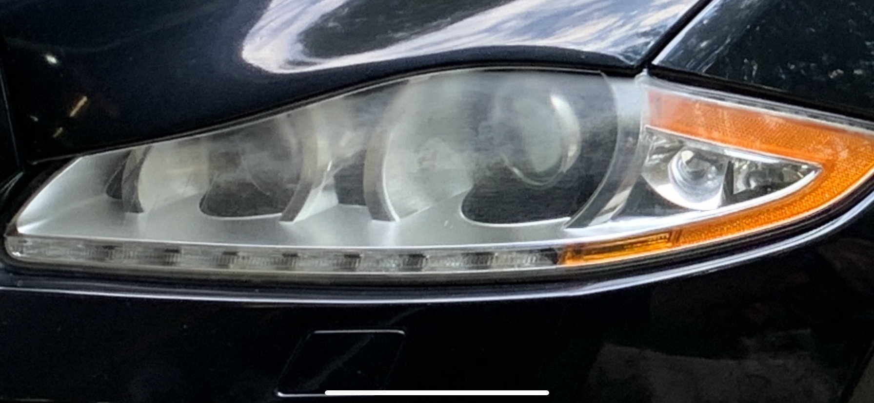

Time to fix these cloudy headlights.

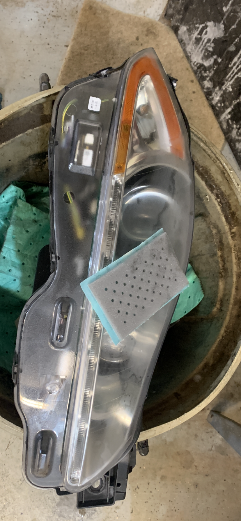

Removed the bumper and headlight assemblies. Was pretty easy using lift.
Ordered this kit.
Use k600 first. Cuts like P350 sand paper and leaves a 600 finish. Use wet or dry. Remove ALL factory UV finish. Make sure you get all discoloration removed.
Next i used the k800 paper and scuffed the entire surface.

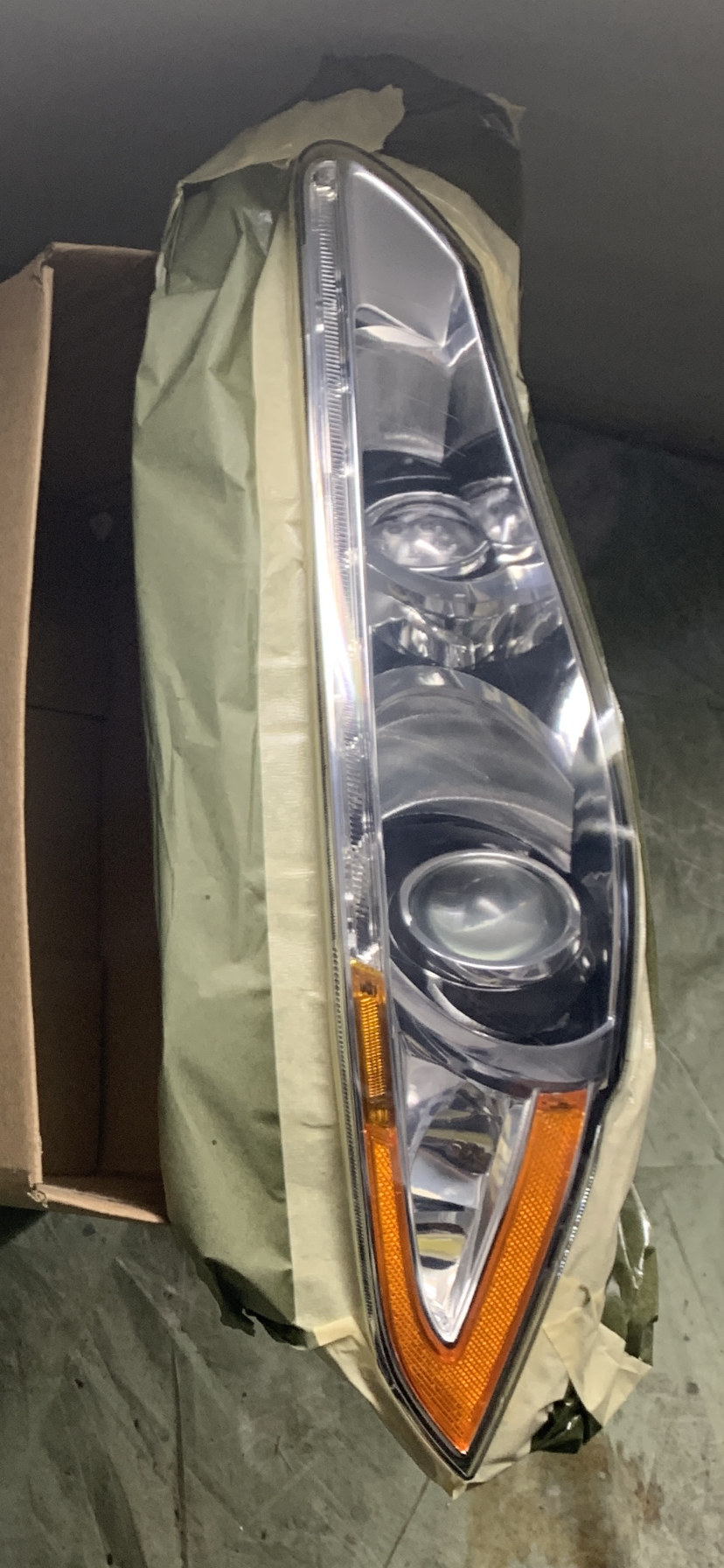

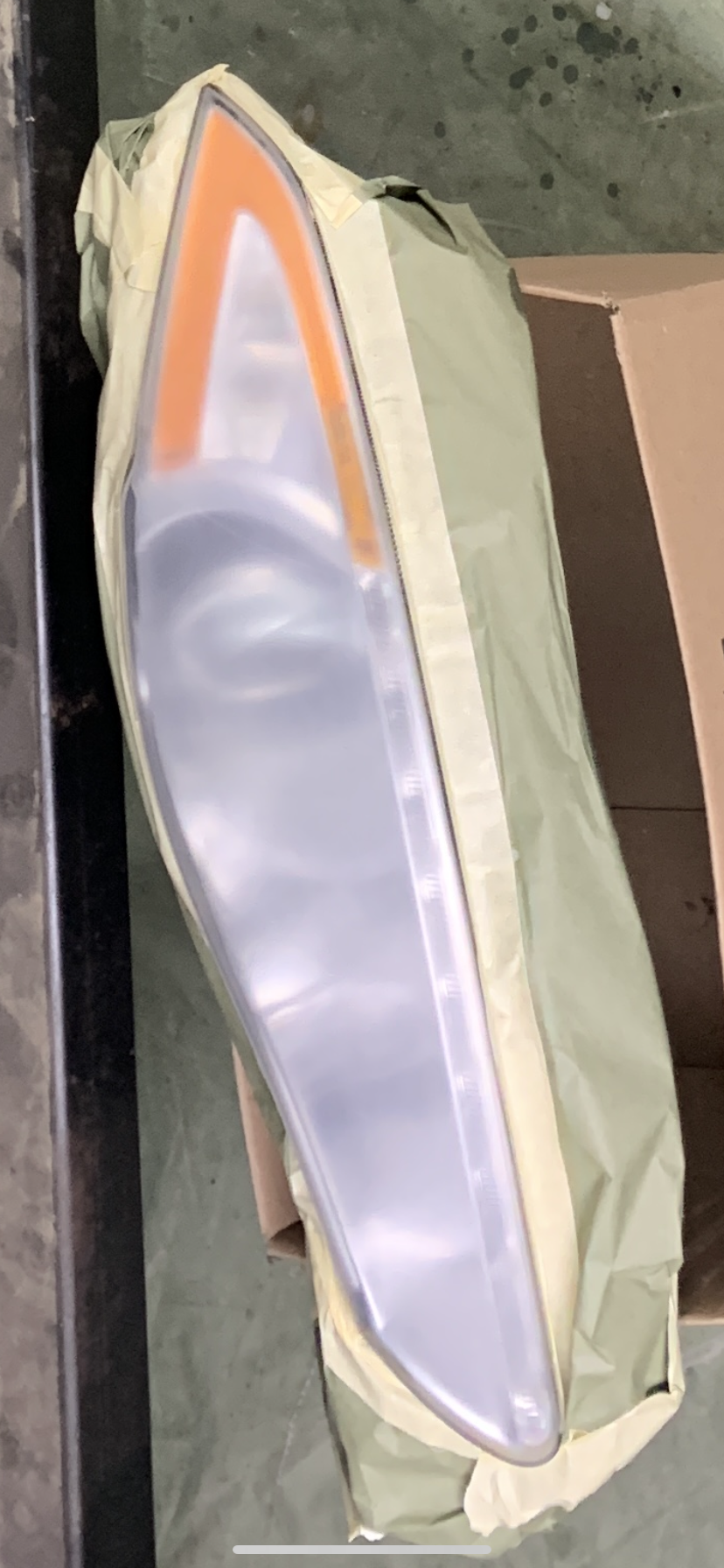

Taped up and ready to clear.
2k clear coat. Went on so nice. Make sure its a dry hot day outside
I put 3 good wet coats with 5 minutes between coats.

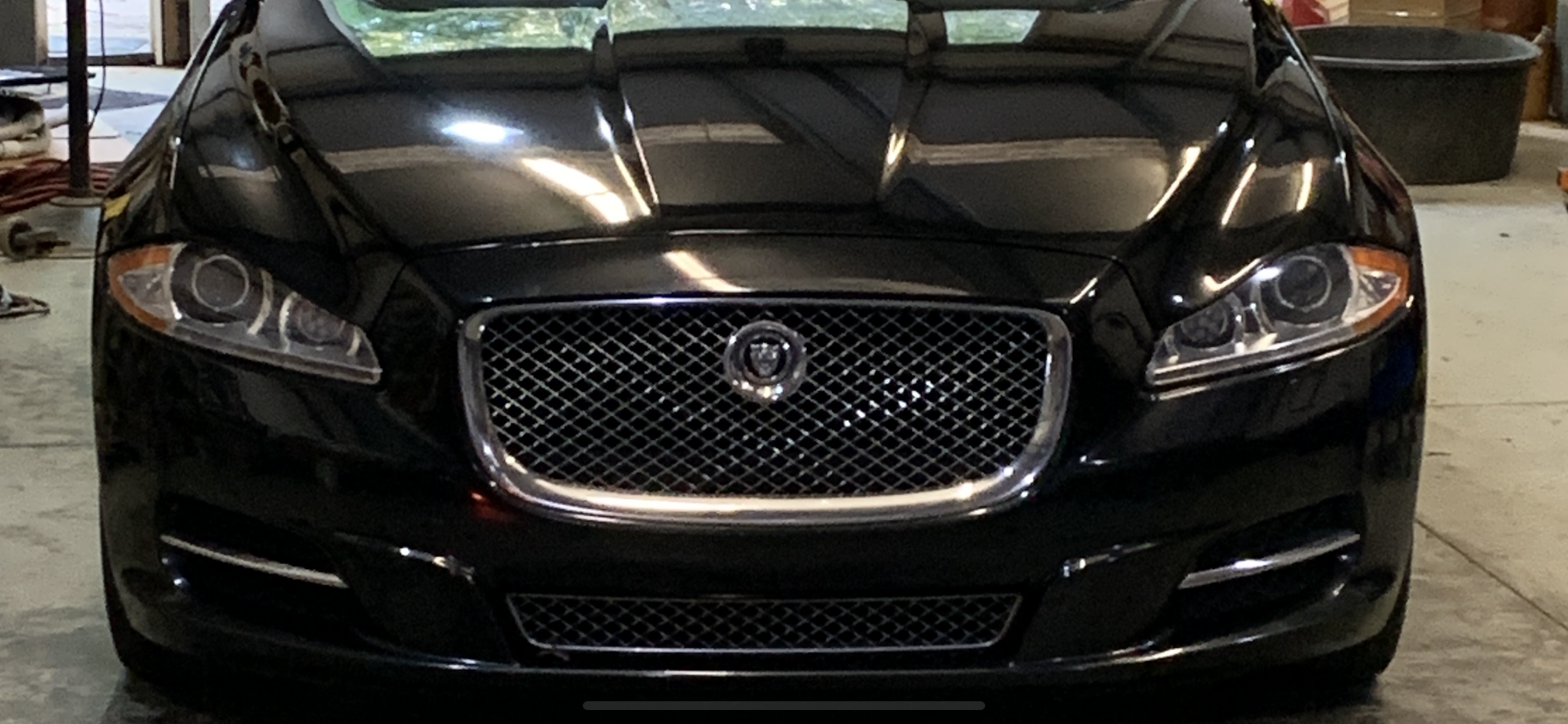

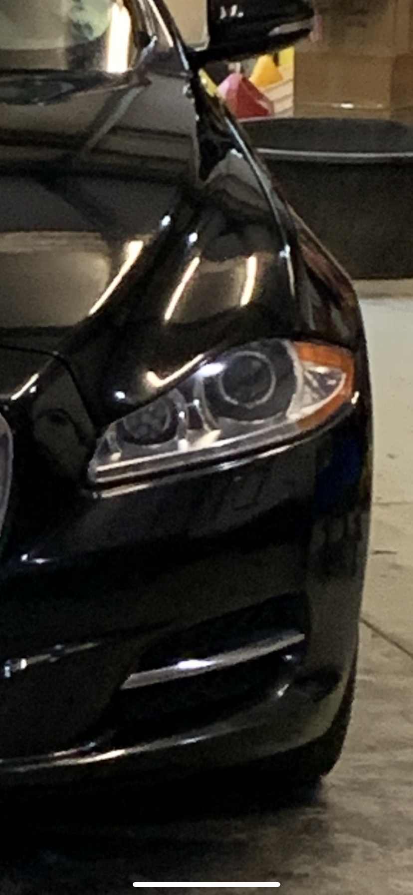

Beautiful
It really makes a difference.
