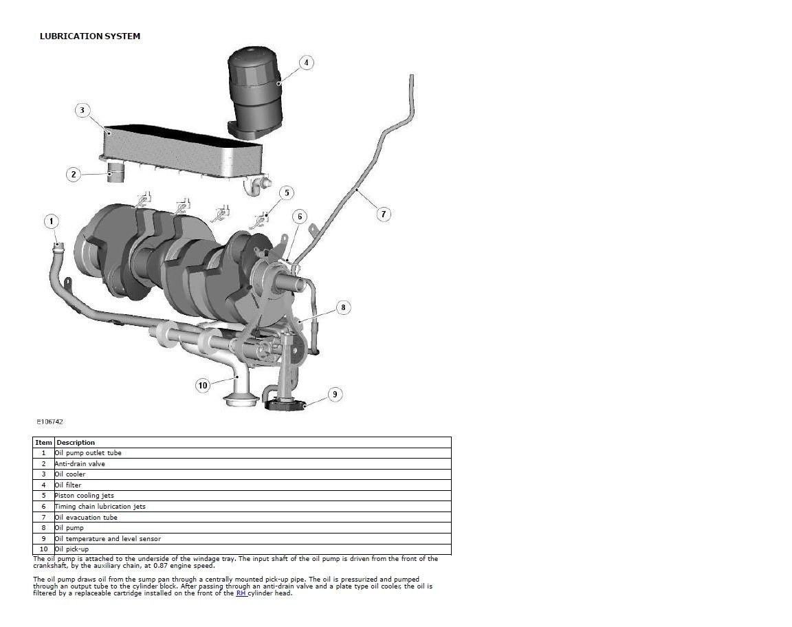

Valley??? Only two things can go wrong with an oil cooler. It either leaks to the pavement or it’s plugged.
Old Aug 2, 2019 | 09:34 AM
DJS's Avatar
DJS
Posts: 6,988
Likes: 2,662
From: Metrowest Boston
It appears our oil cooler is in the valley of the vee? Not what I would have expected, though I don’t claim to know much about them...
[img]blob:https://www.jaguarforums.com/8c5ffe1b-aeb1-408d-951e-4c7ad2449586[/img]
Sorry, tried to paste an image from the repair manual.

Old Aug 2, 2019 | 06:42 PM
OzXFR's Avatar
Posts: 9,016
Likes: 3,655
This might help, from the Workshop Manual:
