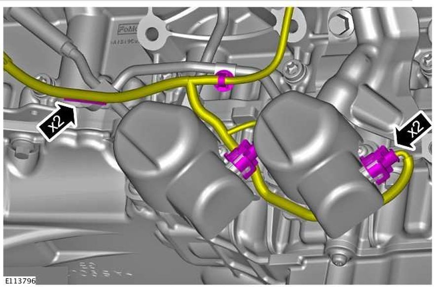

I use a water spray buttle to locate vacuum leaks. With engine at idle, I just squirt a bit of mist at the suspected area.
The V6 firing order is 1:4:2:5:3:6, so by Bank it's, 1,2,1,2,1,2. The V6 actually alternates between Banks, the V8 Doesn't.
The HPFPs alternate pushing fuel to the rails. This is important because only one HPFP is in common with Bank 2. These pumps most common failure is again, the wiring harness.
I'd just disconnect at the pumps, inspect visually. These wires only power a solenoid, the pumps are mechanical, engine driven. The solenoids let fuel into the pumps equal to the fuel needed per combustion event. A gimpy electrical connection or sticky HPFP solenoid can cause lean fuel supply during high power demand.
I doubt it here, because of the work done in the ignition coil area. I only show it because it is a possibility. And certainly, do not pay for a new HPFP when it's more likely a wiring harness problem, it's fine to throw parts at a problem, when money is not precious.
