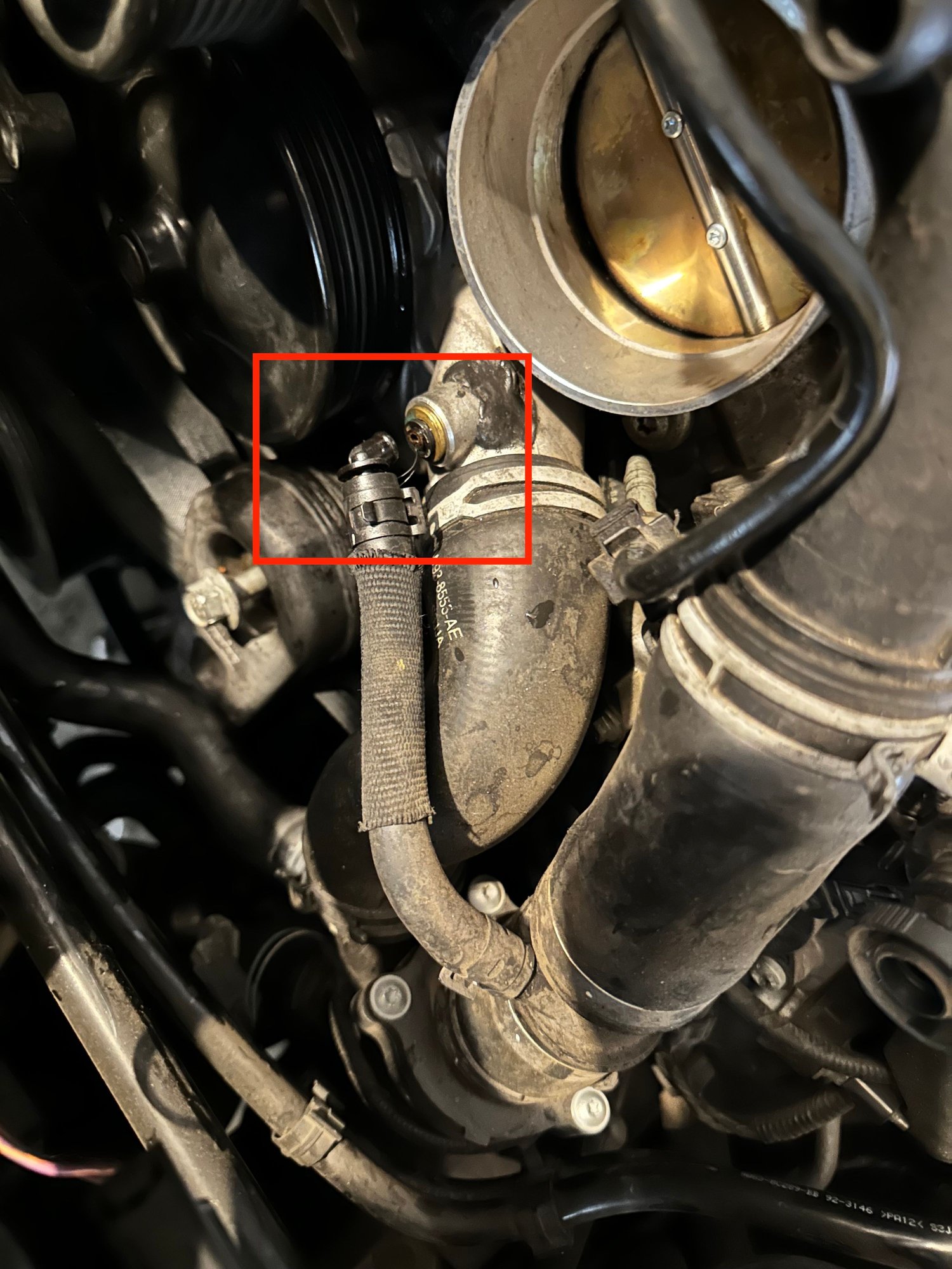

Hi there!
Could someone please let me know what the below component is, and perhaps a part number?
I was a bit impatient while changing the auxiliary drive belt and snapped off the elbow connector
This is a 2015 F-Type V6S.
Thanks in advance.

That circuit is the throttle body coolant line, which keeps the throttle body warm to prevent icing in cold weather. Should be able to track that down in the repair manual posted elsewhere here.

Not real clear on the diagram but I reckon it is this one: https://parts.harperjaguar.com/oem-p...Y2LWdhcw%3D%3D
Engine coolant hose part # C2Z28258.

Thanks guys! That looks right.

In the upper right of the red square on the Aluminum it looks like a gob of JB Weld? Earlier repair maybe?
That's what I thought too, then I saw the exact same thing on a guy's Youtube video where he was replacing the s/c pulley.

Great, thanks. Gonna got with the metal part - the OEM part is really very flimsy.
