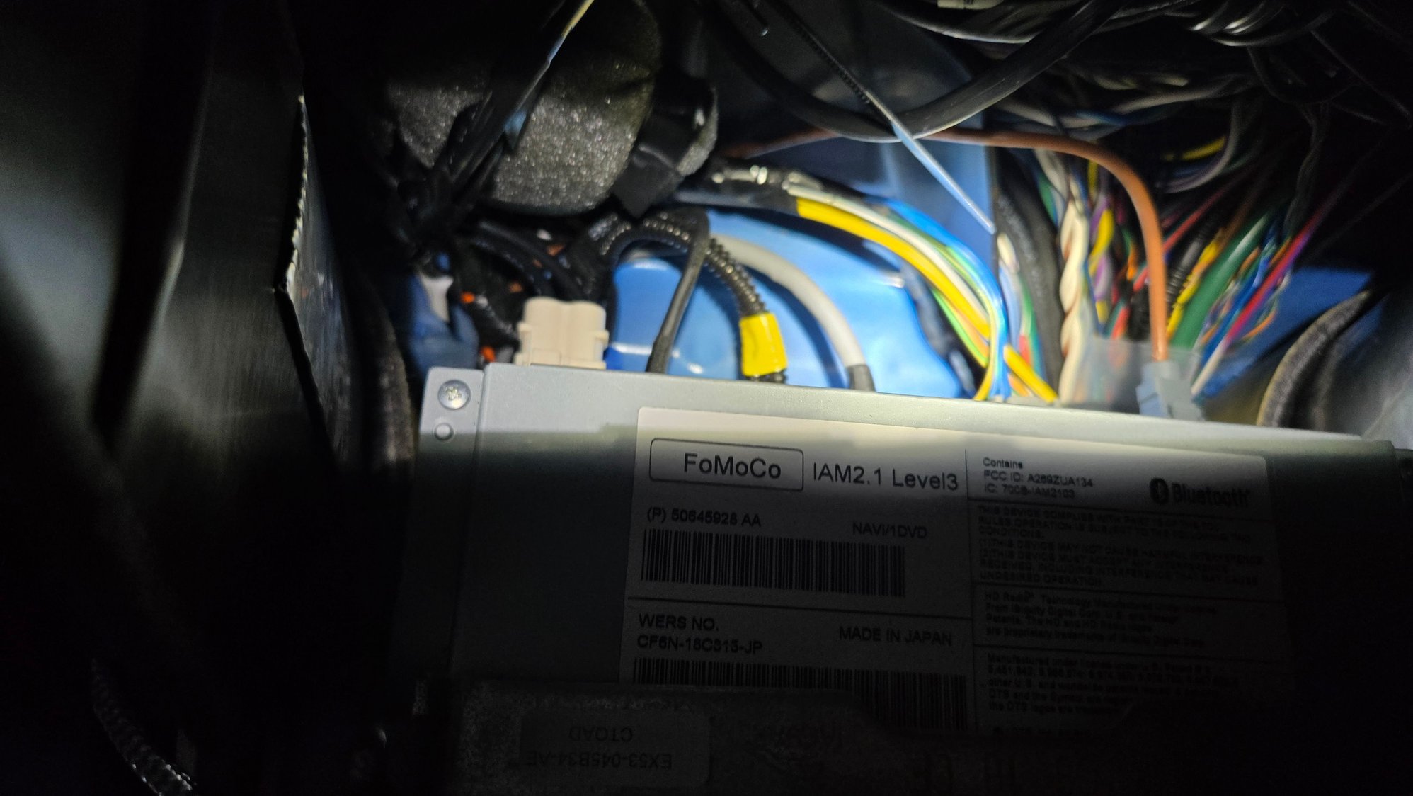

Not a great pic but...if this doesn't cut it then I can pull each and take pics opf the plugs. I can't get my phone back at a better angle without blocking the light.

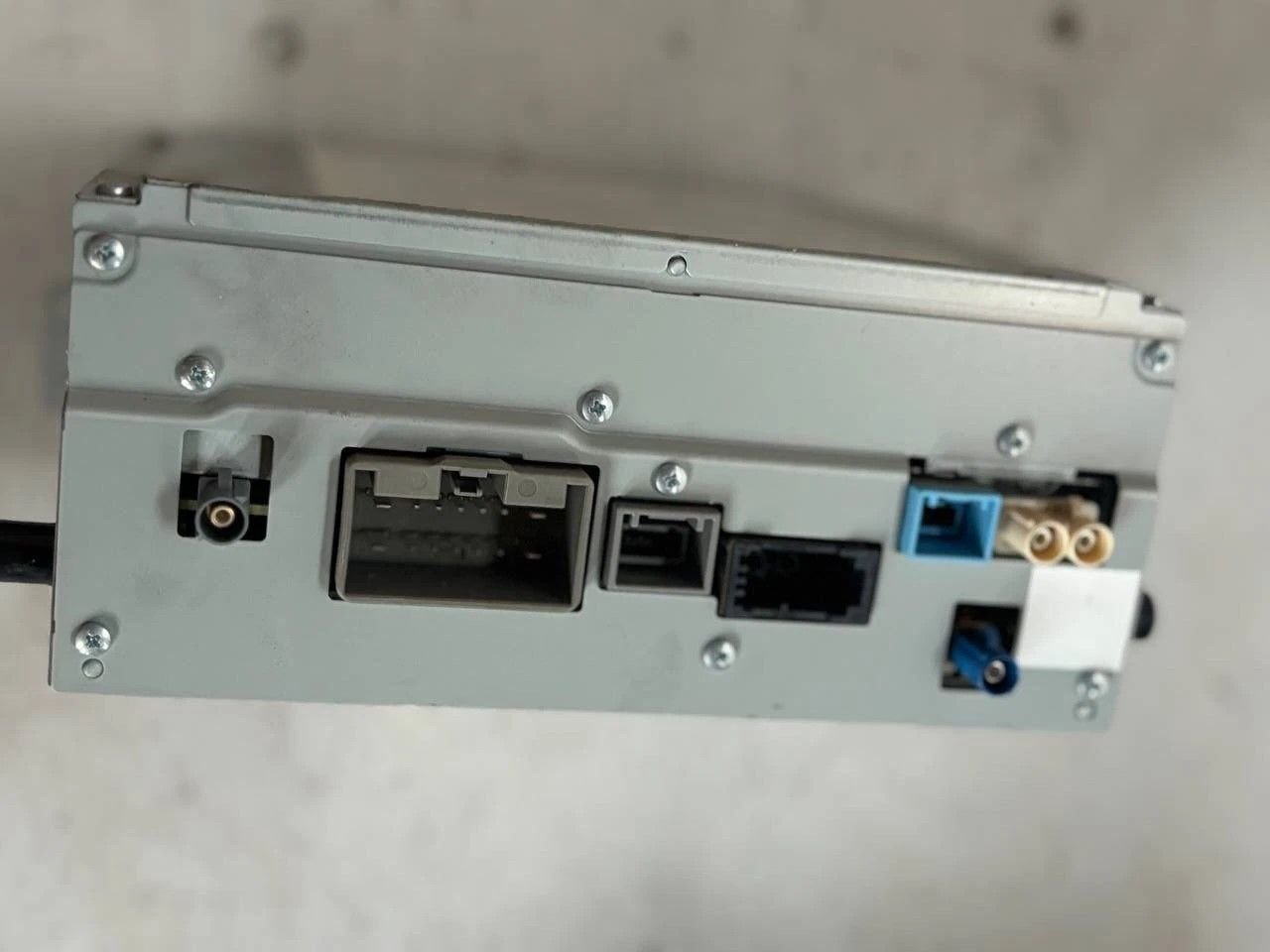

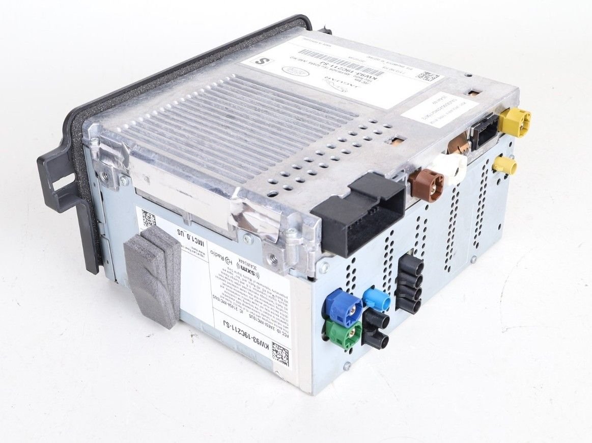

Found this on eBay - same unit that's in my car.
Not 100% sure on what yours has yet from the pics. If you wanted to swing by I can look at he amp connections. Once you know how to take the panels out its pretty quick.

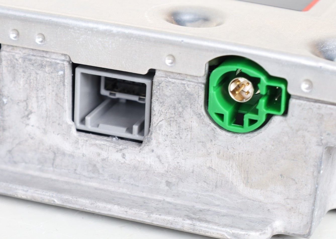

@TH3FRB You have MOST so you will need the mObridge unit. This is what ethernet connectors look like (2018 - present day):

The green one is ethernet?

Yes, digital ethernet in the F-Type uses what is called a Fakara Connection. Not familiar with the MOST stuff so can't help there.

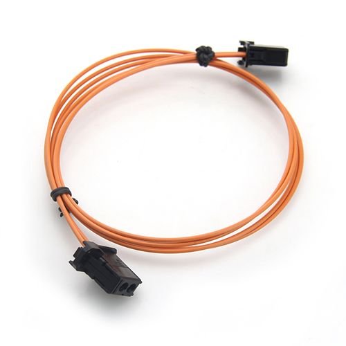

Wow I just realized you have the original FoMoCo combo Radio/CD player! 100% MOST. I wish I had the integrated CD player in my 2019 as I have many from my younger days gathering dust.
The double tan MOST input next to the blue one is likely your audio in and audio out. This is what you plug into. It creates a fiber optic ring of data, much like a TOSLINK cable. Here are what the cables look like.
Get the mObridge kit and don't fuss with trying to tame the high level inputs from the Meridian amp. A pure digital TOSLINK signal will save you much frustration.

You were replying to me, yes? I was thinking that tan double plug might be optical because it needs an in and out. Now I'm leaning towards getting a different DSP that directly accepts TOSLINK input.
