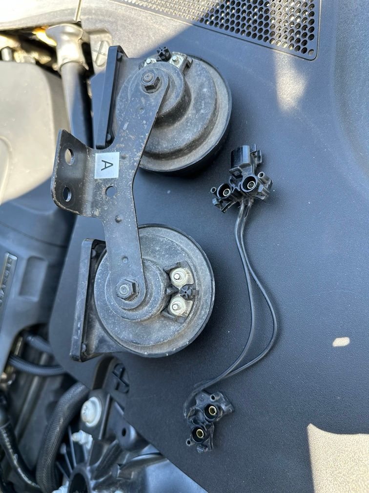

You can easily see both through the grille. If you put on some hearing protection and have someone activate the horn you should be able to figure out which one. Maybe get a dowel hold it against each in turn to feel for vibrations? It might be a bad connection on one. There is a small harness that plugs into the car harness and feeds both horns. Hold on, let me get a picture ...
EDIT: Here you go:
The two units are mirror images of each other but look to have identical numbers. I expected some difference indicating high or low tone. The Supertones, for example, are labeled 300Hz and 500Hz.
