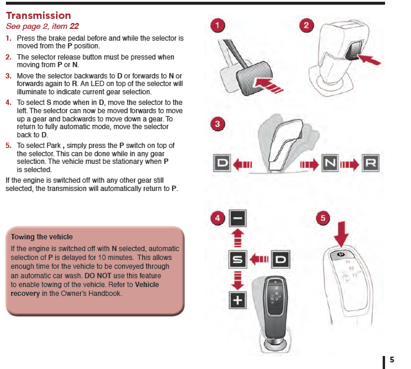

How do you get the transmission in Neutral if the vehicle is disabled? When you shut the vehicle down, it automatically goes into Park. If it has to be loaded onto a rollback truck, how would you roll the vehicle? I have looked all through the Owner's Manual, but can't find anything.

Its no big secret. It's documented on page 5 of the quick start guide

I was not clear in my original post. What if you do not have electrical power? The procedure on page 5 of the book does not work.
