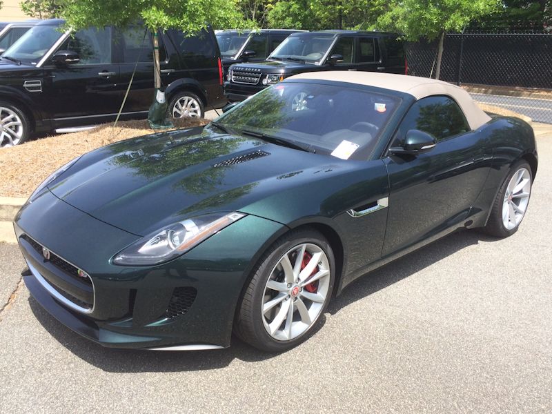

I have a 2017 F-Type S in British racing green with 36,000 miles on it. I had it custom built and took delivery of it on April 30th, 2016. That's right, April 30th 2016. It's going to be out of warranty within the month. I'd sell it, but there's no other car out there that gets me excited. I'm on my 3rd clutch. The first two just broke. It did act up recently again. I had a hard time getting it in to 1st gear after it warmed up. I made it to work, but wouldn't risk driving to the dealership. They hauled it in, but couldn't replicate the problem. I got it back and have driven it a few times without issue. I'm very perplexed. If it's going to fail, I hope that it does so by the end of the month.
After shopping online for a couple of days this post is the first proof I've seen that what I want exists. That being an F-Type convertible with a MT. Is finding an MT Vert a hopeless cause? Any suggestions on where and how to look besides the ones posted in this thread?

I did a search on Autotrader and there are seven manual transmission F-Types for sale across the country, but none of them are convertibles. That seems odd to me. I did order mine. Perhaps Jaguar didn't make them except for those that were ordered.

I also have a manual convertible F-type S. I didn't order mine, but considering options on it, it is likely someone ordered it and didn't take delivery.
