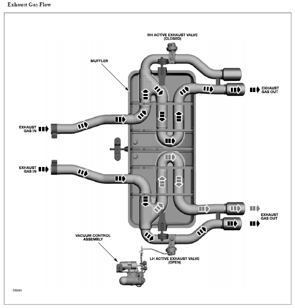

How does the inside of the R rear muffler differ from that of the V6? I think we've all seen the inside of the V6 muffler from the cutaway picture, not sure I recall seeing one for the V8. Where does the deeper tone come from?
Old Jul 24, 2018 | 04:42 PM
alphakinase's Avatar
Joined: Jan 2017
Posts: 312
Likes: 31
From: TX
Nevermind I found it here...
https://www.jaguarforums.com/forum/a...t-gas-flow.jpg

ok from the pic of the last post (alphakinase)
i mean is easy to replace the vaacuum control from v6 to v8 exhaust ?

" the only significant modification needed for this swap would be rerouting the vacuum tubing for the valves"
this is what i need to do
