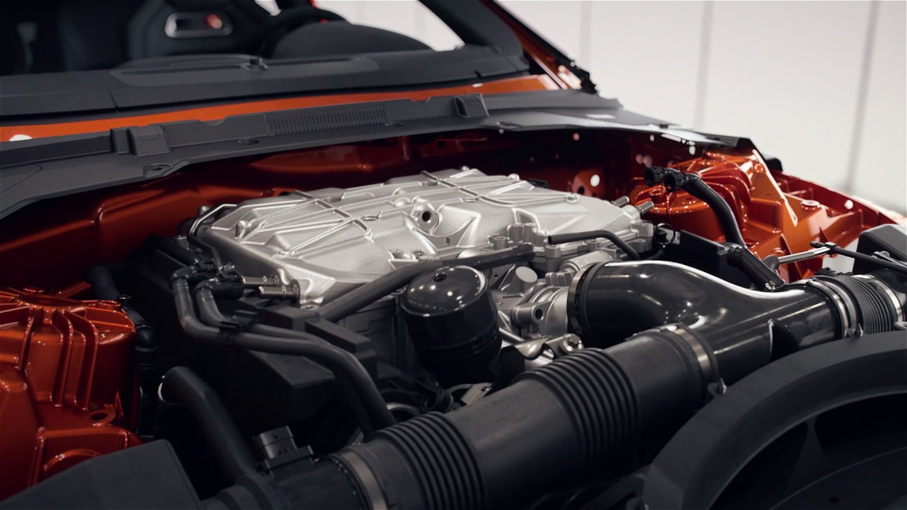

The Project 8 seems to have loads of supercharger whine based on the videos posted by JLR... it also has a different intake tubing system to the V8 F-type. I'd bet they removed the silencers to get that effect. Would be nice if the Project 8 relevant piece of tubing could be ordered as a part from JLR and fitted to the F-type.
Good shout!
Quick google does indeed reveal the Project 8 does not have silenced intake tubes, also air boxes higher up so no doubt create more noise, image attached.
