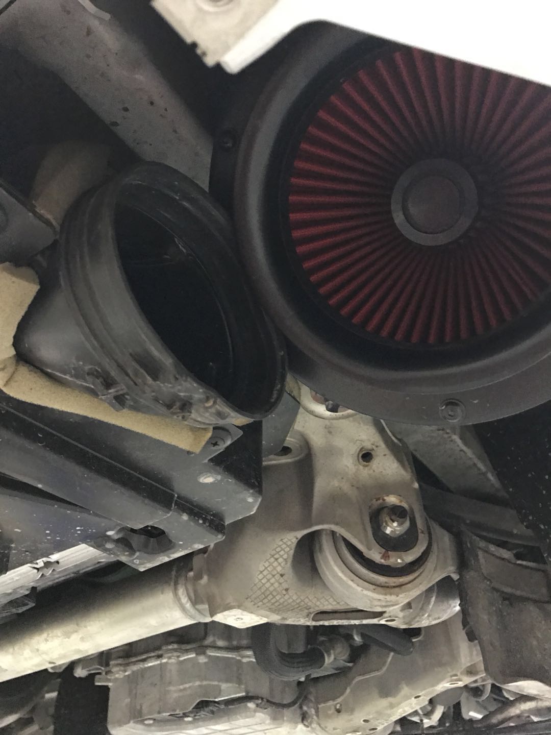

So as you can see that are indeed two snorkels positioned behind the bumper support bar, so quite well positioned but of course air is not been rammed down their throats, they are simply sucking in air from their surrounding including hot air from the radiators/intercoolers.
If one was to essentially build upon these so they can only suck car from the front area and even better extend them towards the grill would result in a ram air effect and of course lower IAT's, the only risk is more water ingress but the airboxes do have holes in the bottom of them as even the stock design lets water in when at highway speed in heavy rain, so this is not something to worry about.
I am probably going to make some make shift (cowboy) direction ducts to feed only cold air from the grill out of some cardboard, which I shall spray black and then waterproof until a more professional solution is available from Stuart at VAP or a company known as Velossa Tech Design specialise in snorkels, they made the one for my Ford Mustang and it fitted very discreetly behind front grill and worked a treat.

Yes parts 11 & 12, the Velossa Big mouths shall fit on the top of them and sit directly behind the front grill next to wear you can see the foam behind the grill.
That foam by the way is for pedestrian safety, of course it can be easily removed, just pulls off, weighs nothing and it then leaves the painted bumper bar exposed so if you did remove it have some gloss black paint to hand.

Count me in, dependent upon the final design. I want to make certain that the placement does not limit airflow to/through the radiators.
Of higher interest to me would be a tube section that eliminates the air tube silencer (numbers 5 & 6 on the diagram).
1. Gibbo - V8 SVR with Velossa snorkels in orange
2. John-Handy V6S Velossa snorkels in matte black (OEM look)
3. dew1551 V8S 2014 convert
4. unhingd V6S in matte black

Stuart at VAP is already looking into that for us and was gonna make some out of aluminium which are then ceramic coated in matt black to look factory, which I did put in my OP.
All been well VAP will supply modified air tube silencers to give more SC whine along with higher flow panel filters.
Velossa Tech will supply the snorkel add-ons to catch more cold air and create ram air effect.
Lastly can someone confirm if the V6 and V8 snorkels are the same please?
Hello, I just wanna make sure we are talking about the snorkel going into the stock intake airbox. On my v6s, the snorkel goes all the way up to upper part of the intercooler/bumper
Can we make it work so that it is compatible with the eventuri intake or other forms of aftermarket intake? The stock snorkel does go to where the eventuri intake would be.
Gibbo, the snorkels on your SVR look to me to be a lot different to the stock snorkels on a V6 (see post # 10, parts 11 and 12). Different shape at the end (cut away) and maybe shorter and sitting lower down behind the grille. It could be that the "cooking" V8 and V6 snorkels are all the same and it's just the SVR ones that are different.
Velossa would need to get a stock V6 and a stock V8 in together to look and compare with each other and with your SVR.
The V6 and R use the same intake ducts (snorkels)
The R and SVR use the same air filter boxes.
This means that the inlet port on all the air filter boxes are the same and an integrated ram inlet duct that is designed to attach directly to the air filter box will fit all models.
P.S. I suspect that the ram air effect on power will be negligible with a supercharged engine. My interest would be to minimize drawing in hot air from around the radiator.
