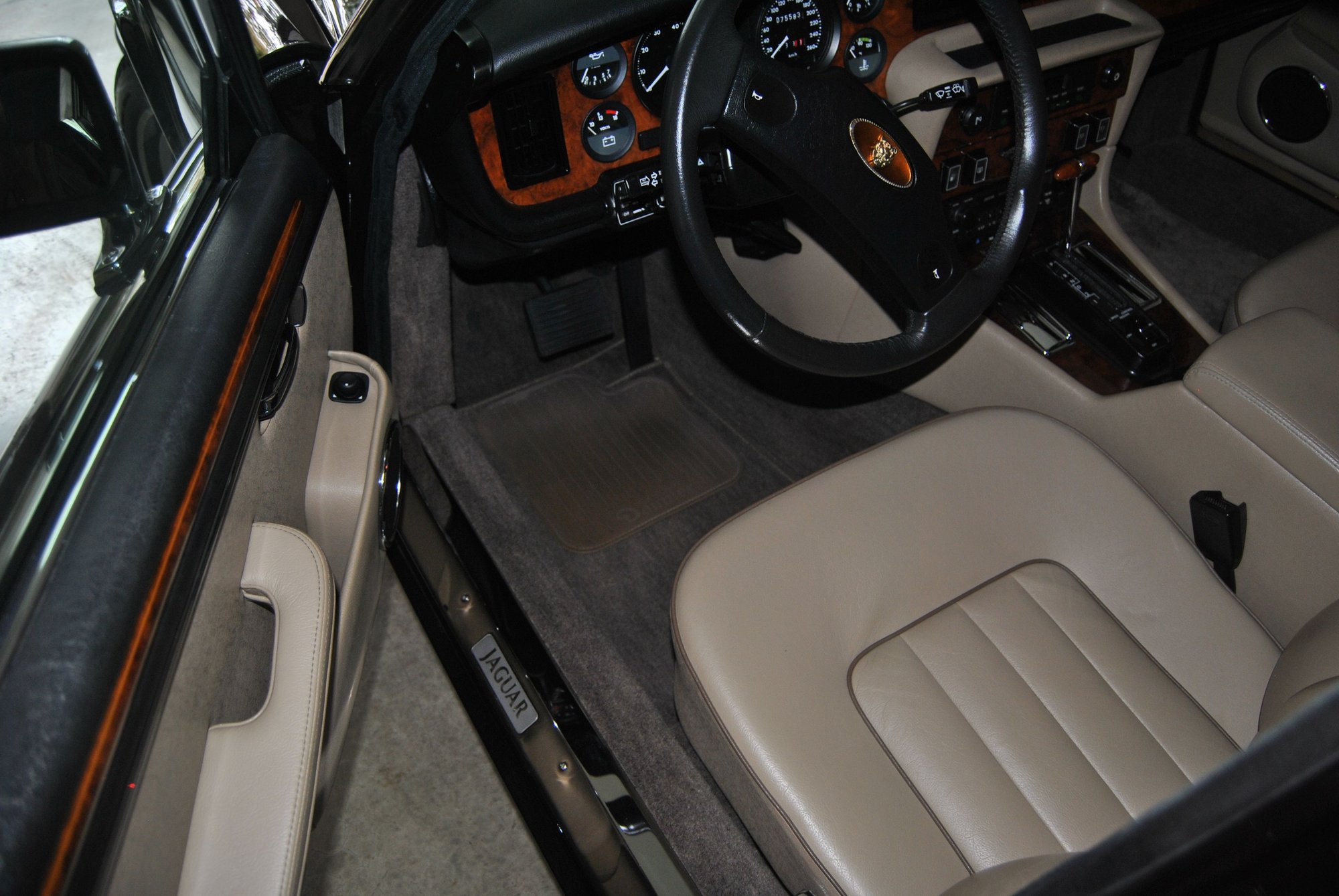

For those who do not believe in the value of conditioning leather, examples from two Series III V12 Vanden Plas interiors: Look at the effect of allowing the leather to age without conditioners: note the distorted piping on the seats, both driver's and passenger seats, caused by the leather drying and shrinking:
In contrast, seats that have been regularly treated with a non-silicone conditioner: note the straight edges, and what cannot be seen so clearly is the soft and supple surface of the leather - and yes, the leather in both cars has the surface colour coat which supposedly does not accept conditioners: The leather is Connolly Autolux (their highest grade) in both cars:
Pictures are worth more than 1000 words, no?

Does seem a tad convincing ;-0
I had asked above, but I’ll ask again: Is your regiment keeping the original matte finish of the leather or does it end up shining up a bit?
Coating or no coating, I guess the realities of potential shrinkage still remains. Half these detailers are probably not thinking or caring about long term realities. Just cleaning and then protecting the leather can’t really address the shrinkage thing. The best you could almost hope for is that the conditioner does eventually break down and get through the coating so it can give the leather a drink to prevent dash and other shrinkage…I suppose…
