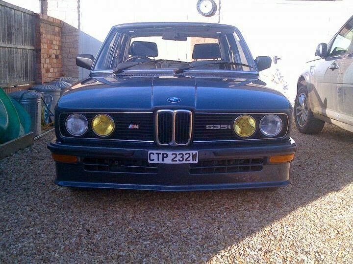

Thanks - that is a good point and did not realize there was a color difference - am not that worried though because the LED's are super bright and will last likely forever - the bulb change is not hard but it "is" a pain in the knuckles. I always sort of liked mismatched lights....call me old school or odd...here is one of my favorite sedans ever:

Yep, that looks super clean. I have a E46 myself that I'm running yellow fogs on. I always considered it the EDM look
