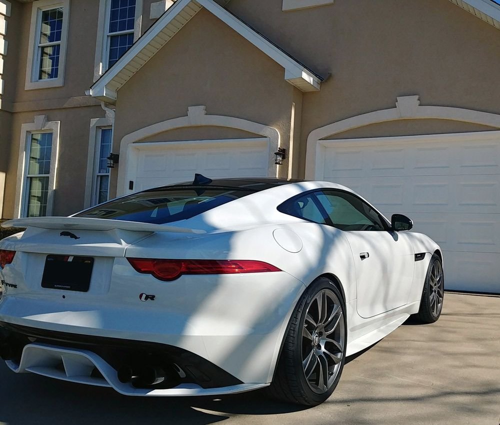

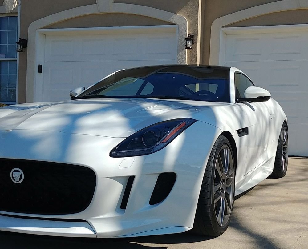

I would suggest the perfect size/offset for 20" below. This is from a wheel calculator I made with Excel. The reason I like this is because it gets the wheels almost perfectly flush with the openings and does not rub when lowered with VAP Springs. All taste, so do what works for you....These sizes get you flush. I used info from spacers in my SS, but the net offset is what you would want to get close to on AM wheels (without 15mm spacers).

Meathead, DC specifies the perfect offsets for any suspension height as long as you don't upsize to 305 wide rear tires. They will rub (ask me how I know). If you are considering 305s, then go with a 28 offset.

Damn, that rear defuser looks good DC.

Thank you sir! I am happy with the way it turned out. Appreciate the compliment..

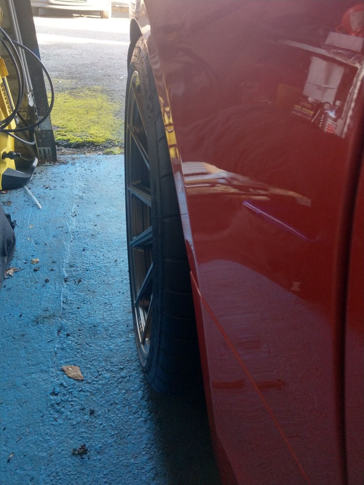

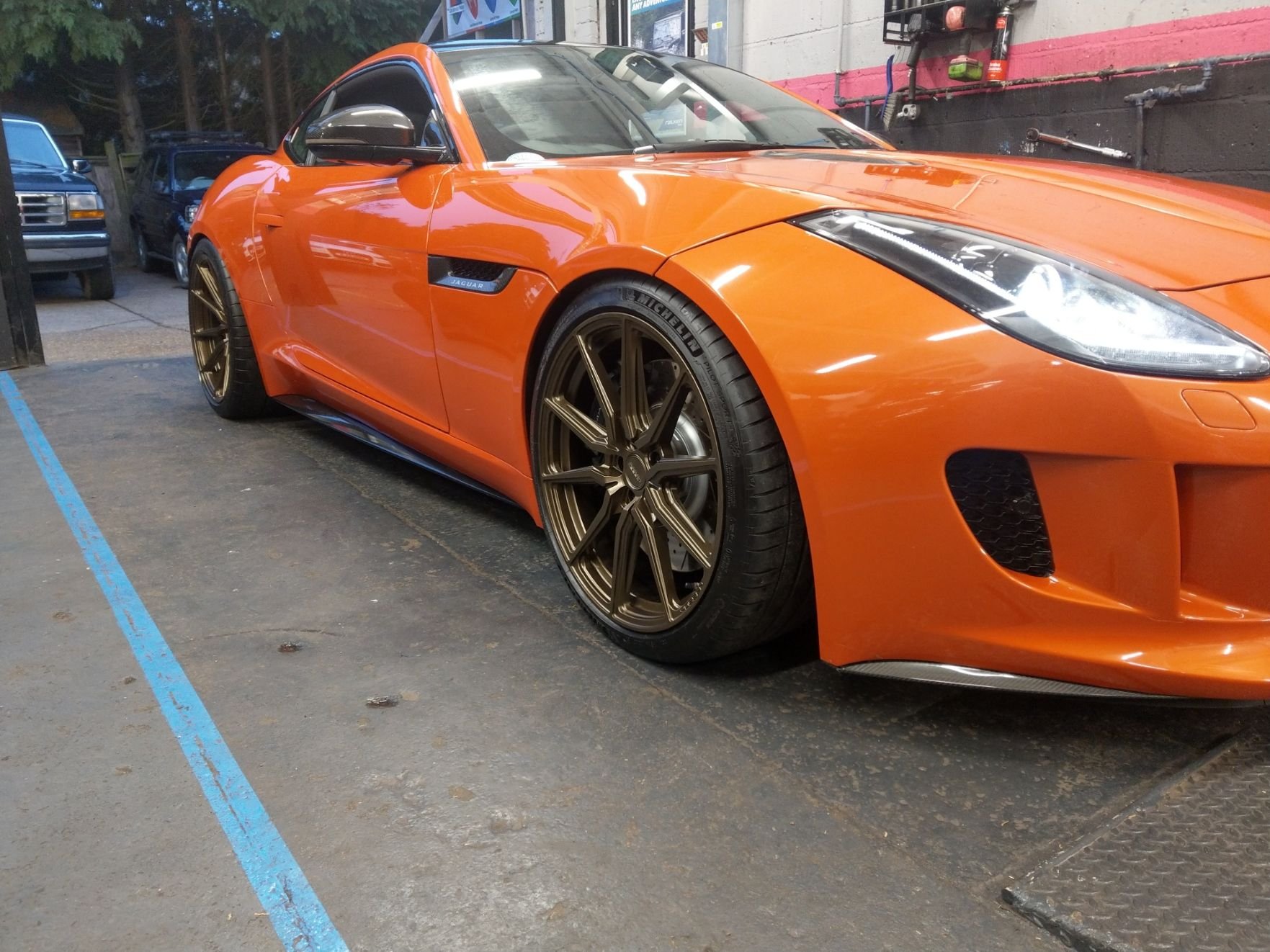

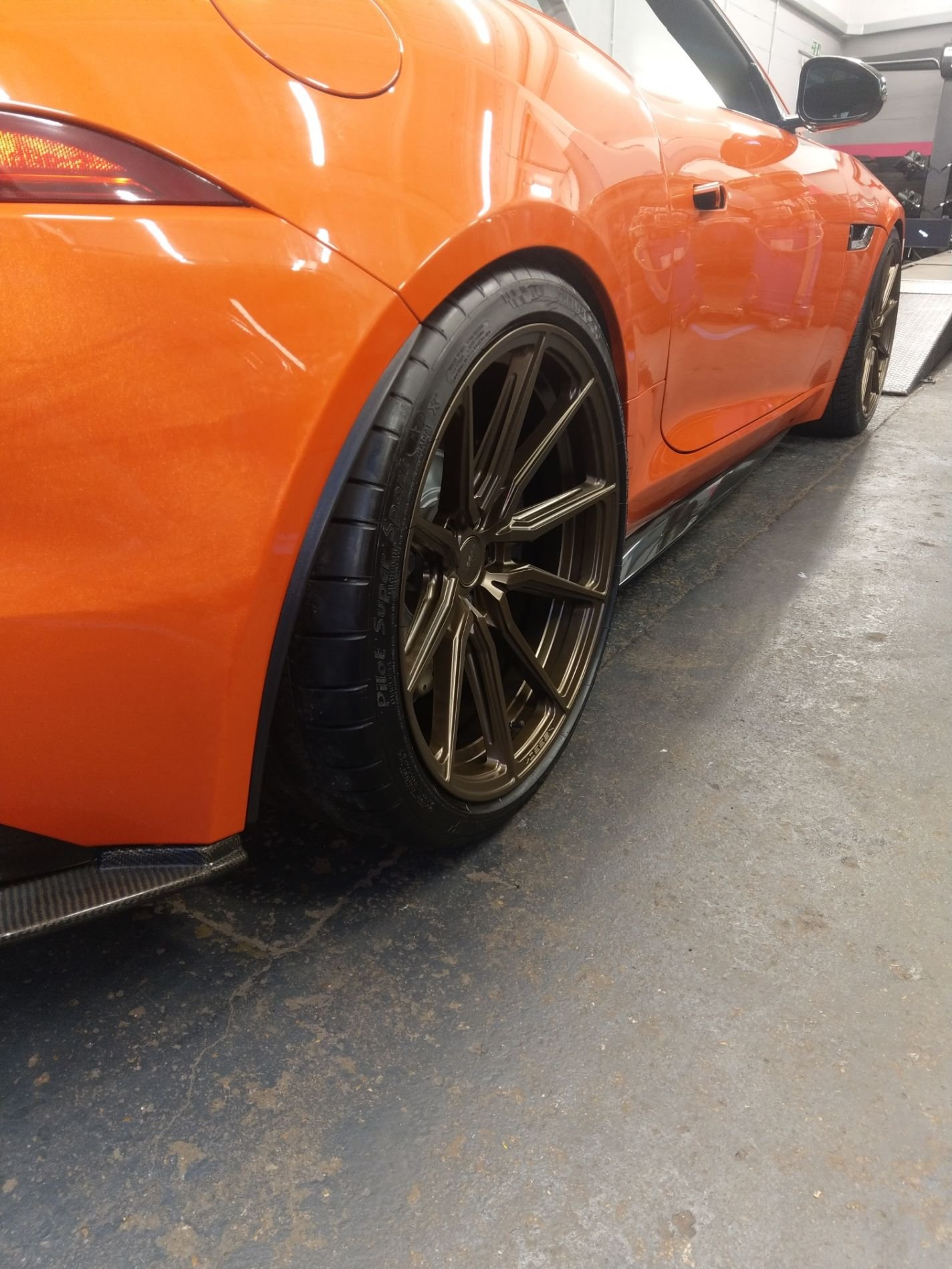

I'll add my 2 penneth worth as i have very extreme offsets, front is 34 and rears are 17 lowered on h&r springs.
Did it rub yes it did lol but only in compressions, so luckily my mate who owns his own tyre shop knows a company called arch enemys.
You know where this is going, anyway the guy came out we looked at the wheel arch and lip and decided that there was plenty of meat on the lip to grind back 8-10mm.
It was scary to watch but he did a first class job even coating the edges with rubberised coating.
Anyway heres the only pics i have for now.

I'd be concerned about loosing fender rigidity by removing that much gusset meat. But, since you can't see those fenders from the driver's seat anyway, it really doesn't matter if they flap in the breeze...
Its fine Unhinged, the bonding goes up the wheel arch.
Its as rigid as it was.
